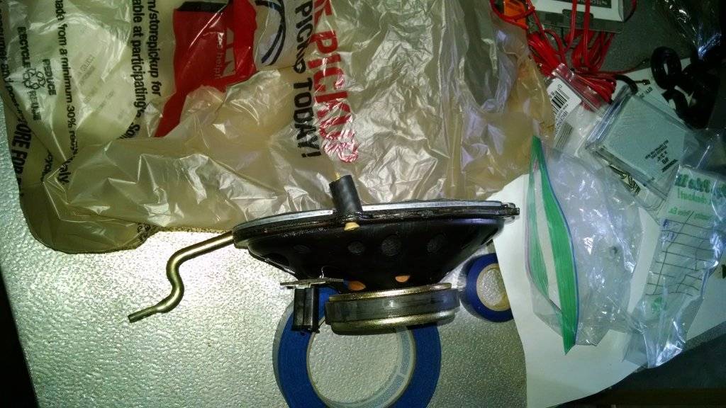

So I needed a better solution. Yes I had to disassemble the entire package shelf, sail panels, and rear window surround to get the top loaded 5x7's out; but I knew I wanted to future proof my 6x9 install. So if I had a speaker failure in the future I could just drop a bad speaker in the trunk, and place a new one up in its place.
My other problem was that these new speakers had elevated tweeters. If I bolted them directly to the package shelf the tweeters would hit the fiber board over-layment.
Solution: The rubber fuel line spacer. I made a template of the speaker mount holes, and from inside the car drilled my new holes through the package shelf. Then I took a sheet metal screw, and placed it through the bottom hole on the speaker. Then I placed a section of fuel line on the screw, and attached the screw from the underside of the package shelf. The screw provides the space for the tweeter, and gives the speaker some vent room, since it does not have a complete 6x9 opening to sound through.
