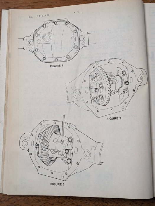

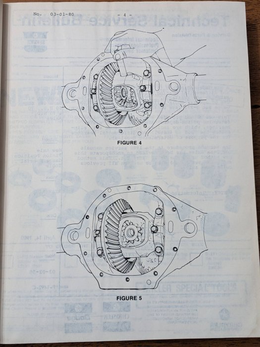

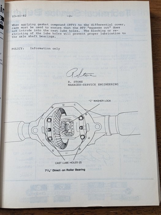

Chrysler Technical Service Bulletins (TSBs) regarding the 7-1/4" rear axle changes in 1980 and 1982, FYI:
