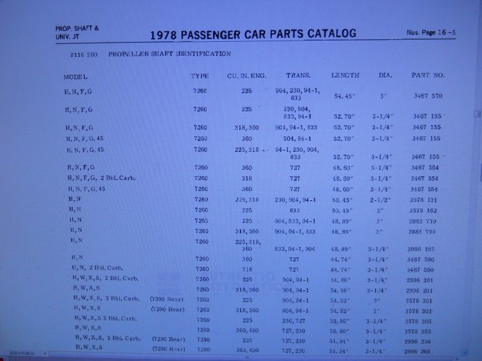

volare 1977
Jun 12, 2014
1,927
303
maryland
chart
