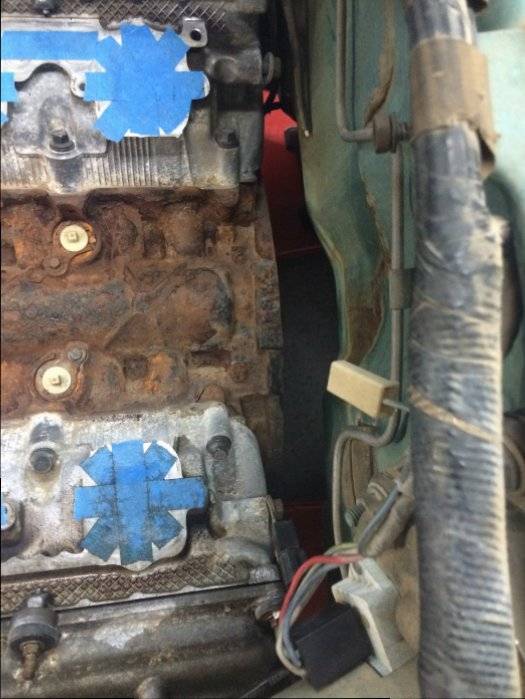

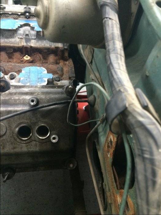

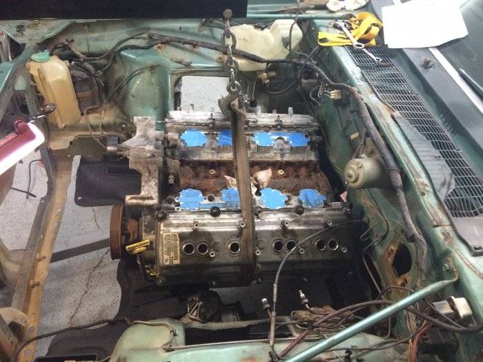

    IMG_4027[1].JPG IMG_4025[1].JPG IMG_4026[1].JPG I would like to tell everyone that I am able to show that these Gen3 Hemi conversion mounts to work. Last night I lowered my 5.7 Hemi into my 79 Dodge Aspen. I have the oil block-off plate, Milodon oil pan, and Schumacher engine mounts. Check out the pics: View attachment 19473 View attachment 19473 IMG_4027[1].JPG

    That's impressive. Thanks for posting pics!
