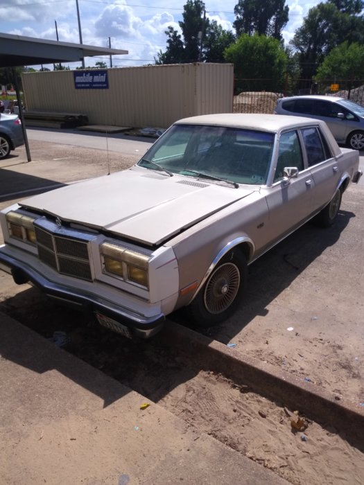

750 Holley double pumper on Slant 6??Will it be to much carb

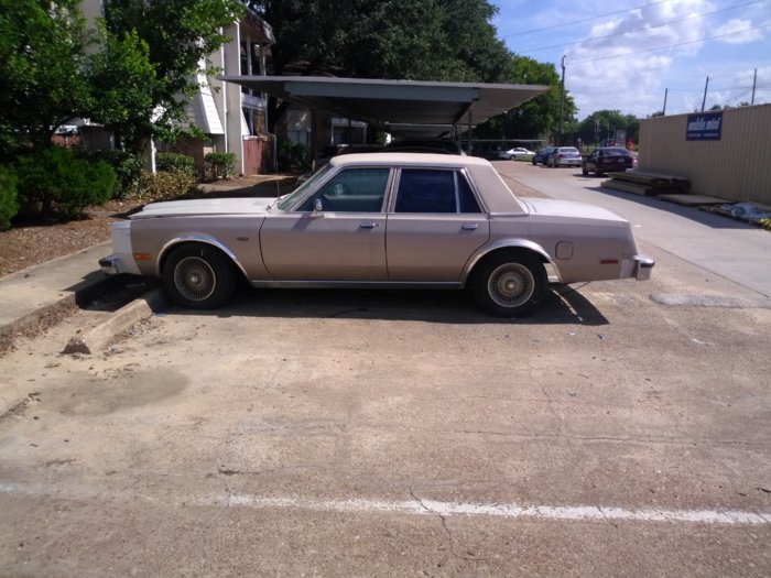

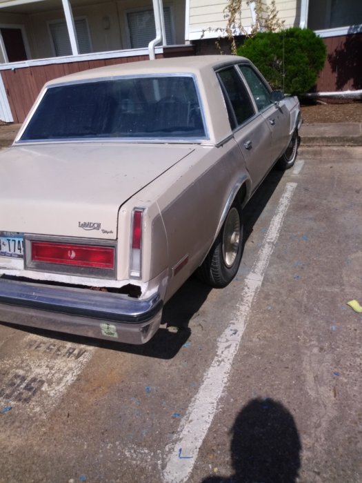

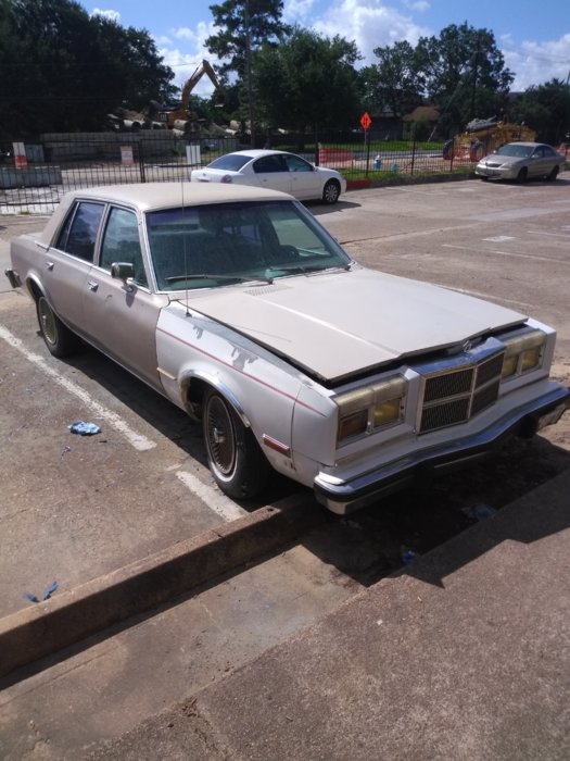

thats wild,a 4 door lebaron..
looks identical to the 5th ave till you get close to the ass end.
the side markers give it away tho.
the 1987 gold 5th ave i got for parts has tan fabric seats,and they are Not power seats either.
they have no adjustments at all.
in fact they are identical to my 1980 lebaron seats,tilt forward only.
Mine are the same way and cause the lebaron was the original and the 5th took the body in 82 and I love the back end remind of a Cutlass
