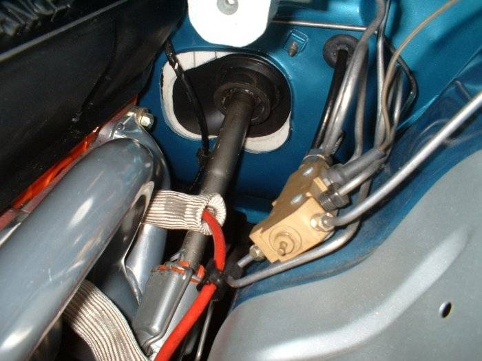

Nice thing about the F (and M's, J's, etc) is because of the rag joint you can rebuild the coupler on the bench. Makes it much easier to get that damn seal retainer on tight.
7,323
2,971
Not all F-bodies have the rag joint. My car doesn't have one. Shaft is solid (except the telescoping part of course) from wheel to box.

thats new to me!
never had one (or seen one) without the rag joint.
never had one with factory manual steering either.
was yours originally manual steering?
and that insane price for new housing is why I've saved every one from the F's (and M) I've parted.
even the BPE rebuild kit is expensive.
7,323
2,971
My car was built with power steering. When looking at the parts catalog, it shows only shafts with rag joints. One of a number of odd things on the car. Maybe because it was a late build (June 18, 1979)? Did the 1980 F's have a rag joint? The rear bumper "shocks" for a '79 don't fit (holes in a different spot) but one's for an '80 do..............
Not that important but now I'm curious.o_O

All of the 80's I've "owned" ;) had rag joints...3 slants and 3 V8's including an R/T.(I checked my evidence files)
Is the passenger side trunk floor to trunk extension/drop seam straight or does it have a jog to it?
Your car seems to be some sort of an... enigma:D
7,323
2,971
No idea about the seam, it's covered by insulation and can't see it. My memory is no help (lol).
This car always did seem to be different,,,,,,,,,,,just like it's owner :D
Kind of like, why did it have the E24 Calif. Emission 225 90hp slug yet, the car was special ordered, built in Hamtramck and sold in Rhinelander WI, which is about 80 miles north of here, according to the paperwork of the original owner (I'm the 2nd owner). Mysteries that will never be solved...............

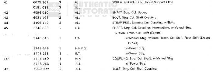

1,492
I don’t think I’ve seen one either, without the rag joint.
It could have been a transition car – but I still don’t think I’ve seen a column like that one, before.
Here are a couple of clips from my ’79 parts manual.

My '79 catalog shows the same thing. Far as I know, it's the original column. The car was about 7 years old when I bought it with 72,000 miles. For that matter, no idea what other column would fit in the first place.
7,323
2,971
Did Police and Taxi have the rag joint? My parts catalog doesn't show anything. The Police/Taxi section is empty.

I couldnt find anything either.
The only thing I can think of is that its an A body lower shaft.
I have an F body column in my Demon, so its similar enough...
7,323
2,971
I'm going to go with that it's an A-body shaft that was put in at some point in the car's first 7 years of life. Why? Who knows?
I was looking on Ebay and it seems if you have manual steering there's couplers or coupler/rebuild kit combos for days. Power steering? Not so much.
I guess we missed the part where you (77aspyn360) asked for the p/n of the coupler and SOMEBODY hijacked your thread (sorry, it was unintentional).:oops:
