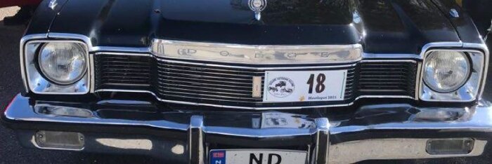

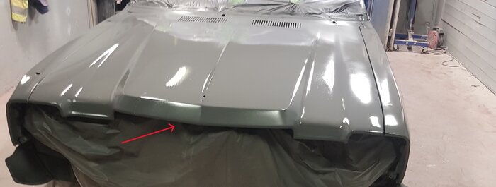

I thought the hood and fenders were the same from '76 to '79?
The difference between 76/77 and 78/79 is the grille itself, and the 76/77 had the taller bracket with trim piece between the hood and grille.
(and of course the park/turn lamps moved from the bumper to grille in '78)
If my memory is not way off that means you should only need the bracket and trim to convert to the '77 grille.
Not 100% sure about this though, hopefully someone can verify or vice versa.

Also do you know if changing the 79 hood and putting a 77 will I have to change the hood latch as well?
7,323
2,971
Fenders and hood are the same 1976-1979. '76/'77 Aspen uses a trim piece in the raised part of the hood in front, to meet up with the Gen 1 grille. Hood latch is also the same.
In other words, all you need are the right trim pieces. No sheetmetal change needed.
You will need a 76/77 bumper and park/signal lamps though.
