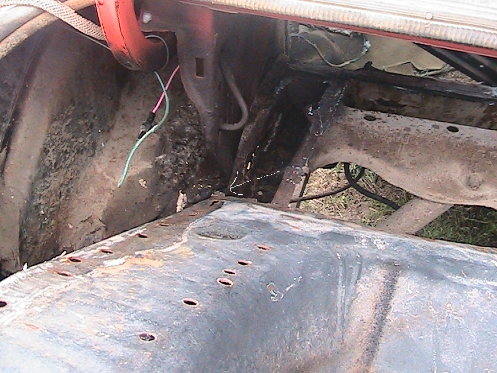

Ok, Not sure if I am missing something here or I am just Stewpid.
I got the replacement floor pan from Jim and Got all of mine Cut out and ground down to accept new welds but for some reason, and I know Jim probably takes other stuff out of the way before getting these pans ready to go, no matter what way I finagle the thing, it won't fit through the trunk opening. Not only that, the Trunk Lid Mounting (Verticle) brackets that hold the tension bars are in the way too (the end that slides into there is too wide to slide between those verticle brackets). Do I have to REMOVE those to?? I really don't want to. How do I get this thing into the trunk without cutting the hell out of the replacement pan???

I don't think even going in from the Bottom is going to help, the trunk pan is wider than the Frame Rails and those Vertical Trunk Lid Supports are still going to get into the way.
--- Post updated ---

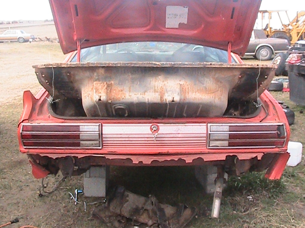

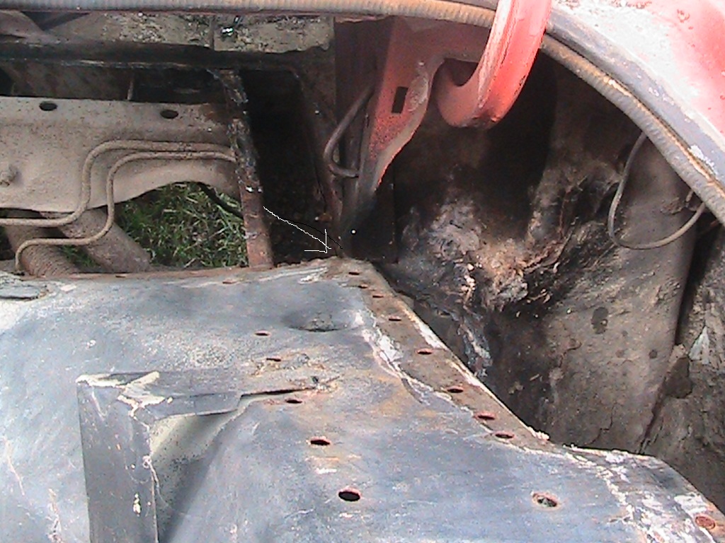

Here's 3 Pics of what I am talking about. Also, won't the Support Beam that the Shocks bolt to prevent that pan from going in from the Bottom (as well as the Frame Rails) as it's about 4 inches fwd of where the Trunk Pan is going to go. Those Vertical Trunk supports are just inside of the edge of the Trunk Pan.
7,087
About the only way to get it in there in one piece is to remove the tail panel and slide it in from the back. Actually, that's the ONLY way. Other choice is cut it in half and then weld it back together once it's in.
At least that's the way I've seen it done on B and e-body cars (tail panel removed). Of course, those don't have the deep well in the center to interfere with the rear crossbrace. The main reason repop trunk pans are offered in one piece or two piece.
Sorry, I know that's not what you wanted to hear. Just remember, if cut in half, most of the weld will be hidden from underneath by the fuel tank and if you carpet the inside of the trunk.....................

looks like it would go in if you removed the trunk hinge support?
Or maybe cut the lower portion . Probably best to cut the pan in half like aspen500 said.

Might want to look at what it takes to remove the rear most metal finish panel (taillights) first. I have no clue, otherwise, but I’d agree, Cutting and welding that pan is not going to be fun.
I do know on A & B bodies, the trunk pan comes in two piece and one piece (which requires the rear most finish panel Removal).
