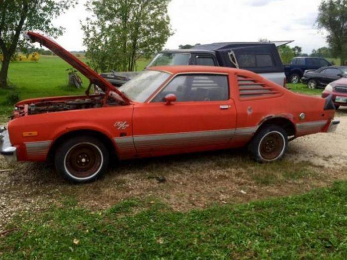

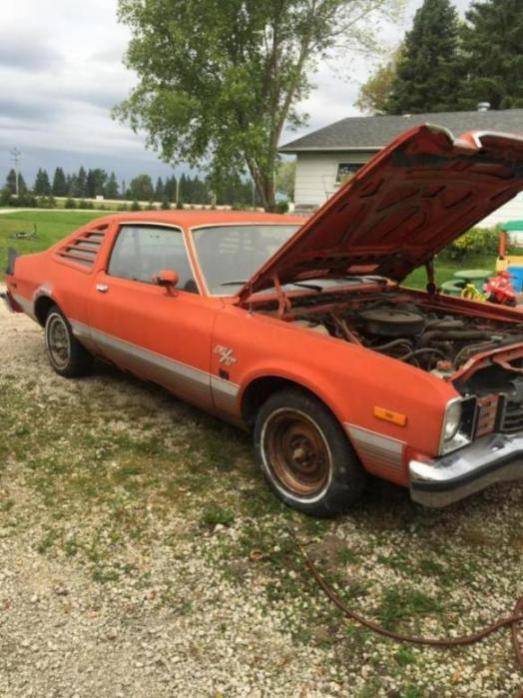

    Slight damage to front drivers fender.

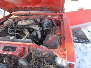

    This is when I got the car to a friends.
