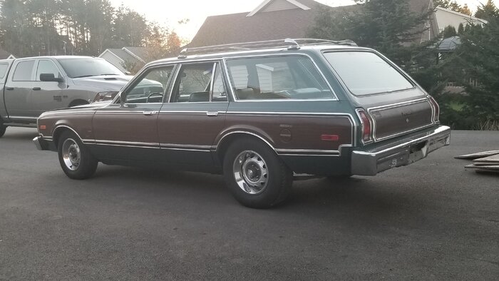

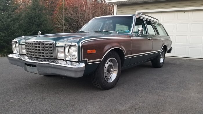

Had a friend coming to Eastern Canada back in the Fall with an empty trailer and the opportunity to bring me a winter project. Scanning Craigslist and Facebook marketplace I was able to find this gem... It changed hands since this feature but only had a few more miles on it.
Premier Condition! 1979 Plymouth Volare Wagon

Home in the driveway! Then the work began!

The car turned out to be pretty good. Other then some pretty good rock chips in the rockers and some splits in the pleats of the seats....the car is pretty much completely original....70,000 miles and all original

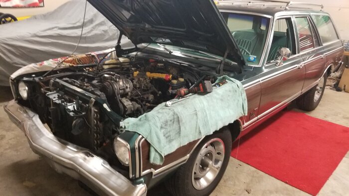

Hey, very nice car and a great project idea.
My recommendation would be: get some help (if need be) and get that hood off the car, it'll make any job that much easier...and boy, it'll brighten up the engine bay...light everywhere!!

Yes the dark green along with light placement in my garage doesnt help!

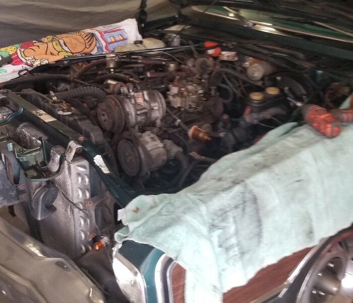

1,492
The A/C compressor (if good) can be used on an 318/360. Both /6 A/C hoses are longer than what the LA uses - but heard they will work fine (not seen this first hand, though) for small block conversions.
If you are planning on removing/installing the engine from above, then hood removal is VERY HELPFUL.

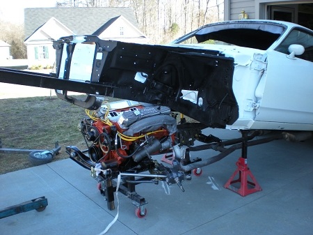

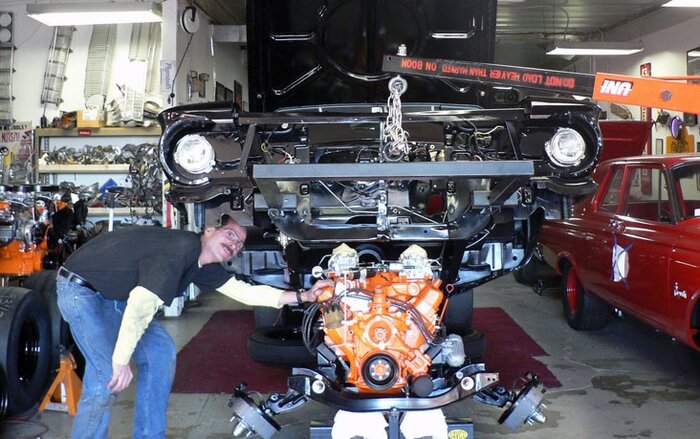

If you are considering headers with your 360 install, I might suggest dropping the engine/transmission/K-frame/front suspension down (as an assembly, as shown below) and lifting the body up. If will give you more room to tidy things (or clean) on suspension and/or engine compartment (if going that route) and a much much much easier time installing headers.
Even rebuilding the front suspension is a lot easier (if needed to be done, that is).
With the powertrain/suspension out like that, the front end of vehicle is surprisingly light (but not light as a feather).

I wish I could have done that. I am not comfortable that I have the ceiling height or the travel in my engine hoist to get the car high enough. With my luck....well we won't go there lol

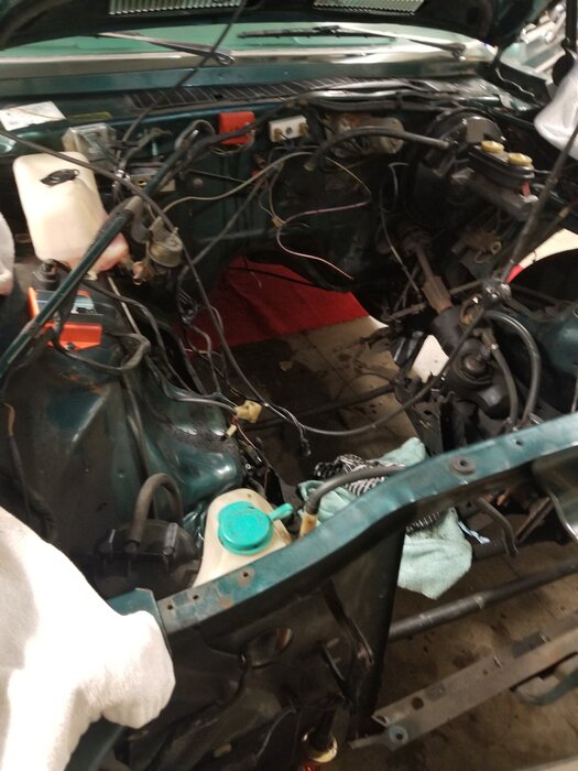

Blank canvas! V8 Kframe conversion coming up next. Would love to have found some Shumacher conversion mounts but no dice.... So the wagon gets a freshly blasted and painted K with poly iso bushings and all new ball joints and control arm bushings. Do it once and should be good forever right?

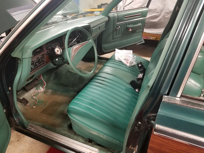

Cold weekend so it was time to put the interior back together. It's all original except for the seat bottoms where some carefully matched vinyl replaced the split seams. You can see a color variation in the pictures more then in person actually. Oh well best we could do. Mounting up a tach and will be moving on to an oil psi gauge next

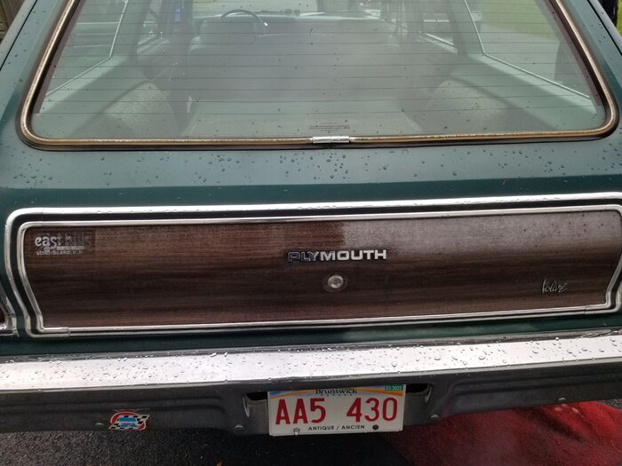

Wood was good except tailgate. Must have lived in a carport or a garage that had the door open a fair bit. A few treatments of trim restorer did wonders though. Here is the comparison after one treatment

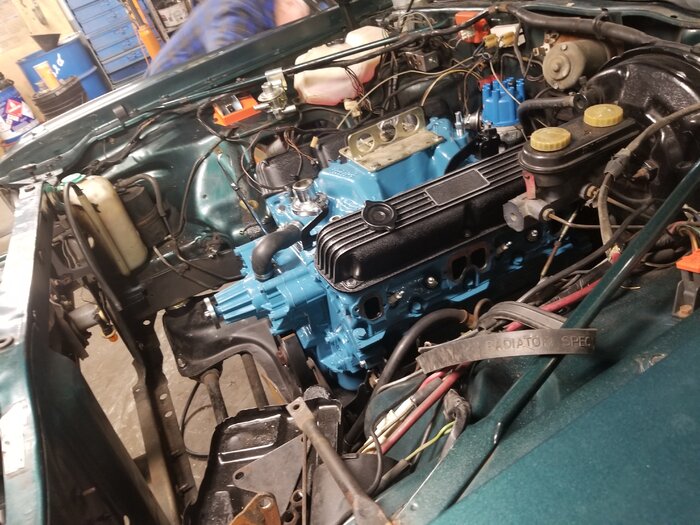

Well it fit! My biggest issue was lining up a good set of proper pulleys. All in all I'm pretty happy with it. Exhaust and alignment and shes ready for the road
