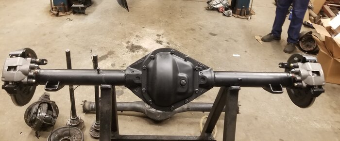

I didn't explicitly need to go D60 myself with an automatic, but never wanted to touch it again. This unit came out of an early 80's F250 and was a full floater. Had the tubes cut down and changed over to a semi-float using Ford ends to run an Explorer disc brake kit. Got all the parts through Doctor Diff.
