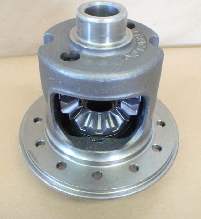

The 8¼” axle spine count changed in ’96 – but that only affects the axle shafts and spider gears (or carrier).
The ring and pinion gear set is not affected by axle spline count – unless you are also changing the carrier (the part the ring bolts to) as well.
As far as I’m aware, all Chrysler 8¼” ring and pinion gear sets made from ’68 to present (including pickups, vans and Jeeps) will interchange, as a matched set - with the exception of the high ratio gears.
The 8¼” carriers (above picture) are where the gear ratio difference matters. If you currently have 2.93/2.94 gears, then yes, 3.55, 3.73, etc. will all fit.
If you have an 8¼” with 2.2 gears, to change to lower gears, you would also need to change the carrier as well.

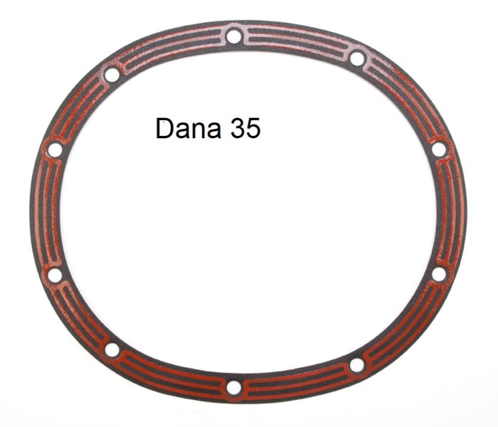

When looking at jeep gears, it can be easy to get a Dana 35 and Dana 44 mixed up with the Chrysler 8¼” – for some came with all three differentials as an option.
Dana 35 has a 7.6” ring gear and Dana 44 is 8.5”

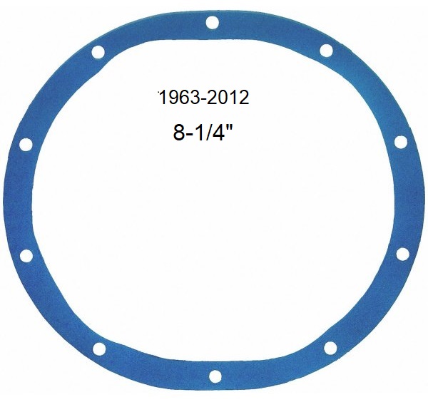

To make it more confusing, the 8¼” cover is oval shaped

As well as the D35
Both versions use 10 bolts.

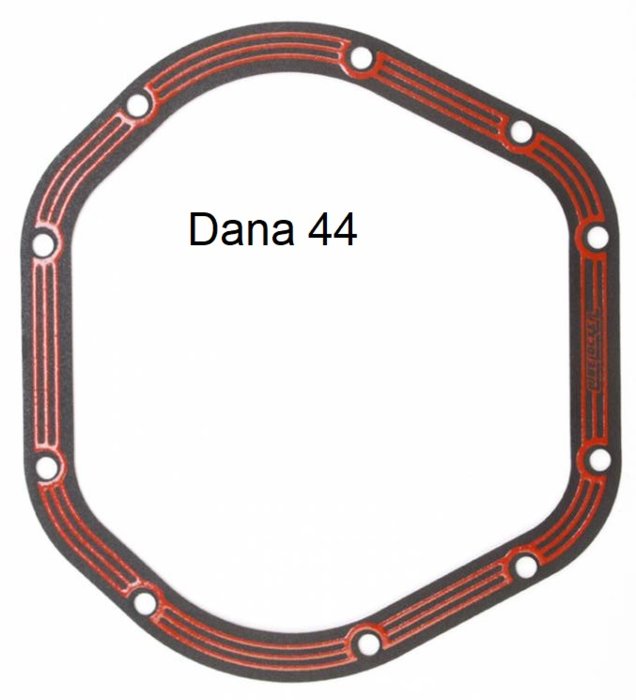

The D44 is easier to tell apart

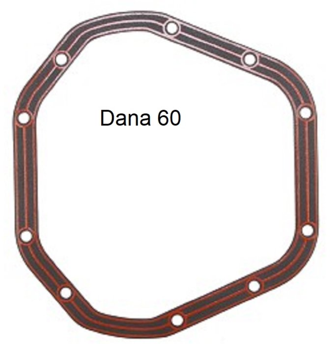

But then it gets confused with the Dana 60
