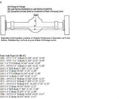

Year Axle Type (A) (B) (C)
All 7 1/4" F/J/M-Body 54.340" 44.46" 10.09"
All 8 1/4" F/J/M-Body 54.340" 44.46" 11.69"
1962 - 1970 8 3/4" B-Body 55.000" 44.00" 12.35"
