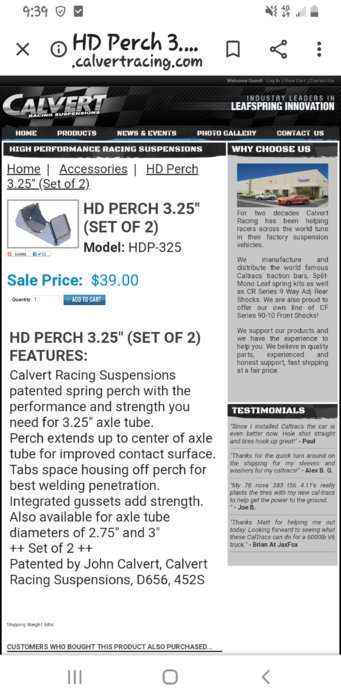

Here are 3 1/4" spring perches for the 8.8 from Calvert.
