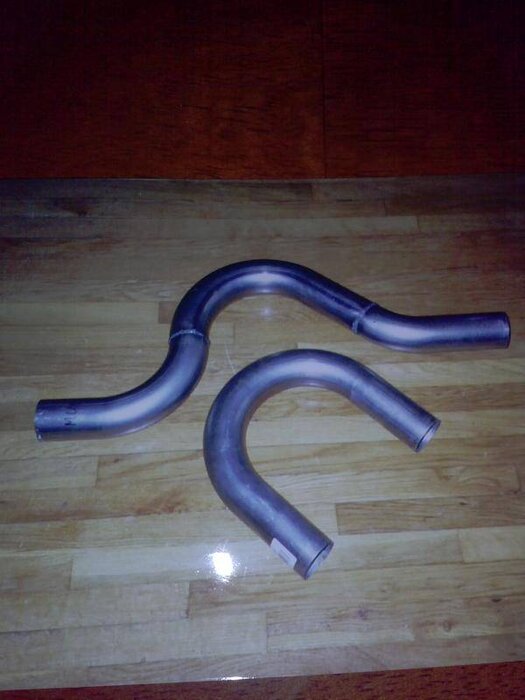

If you got beer and a MigWelder you can fab up your own exhaust using 180* pre bent U Bends..... Pic is “up over the axle” tail pipe.

Well, I don't drink, and I don't have a welder LOL I got a quote from PF&E and they're excited to work on this for me. 2.25 inch to the back with Super Turbos and B-body style turn downs.

You'll like Gary, him and his crew do good work. They're the shop that fabricated my stainless headers. To give you an idea of the workmanship difference between them and Doug's: I had Doug's do a dual system for me and while they did a good job bending the pipe, it was hung with sheet metal screws through the rear floor boards. I was pissed. They even fell out. PF&E actually welded studs to the seatbelt support brackets under the rear seat to secure it.
You get what you pay for.

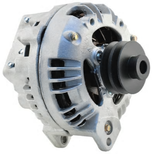

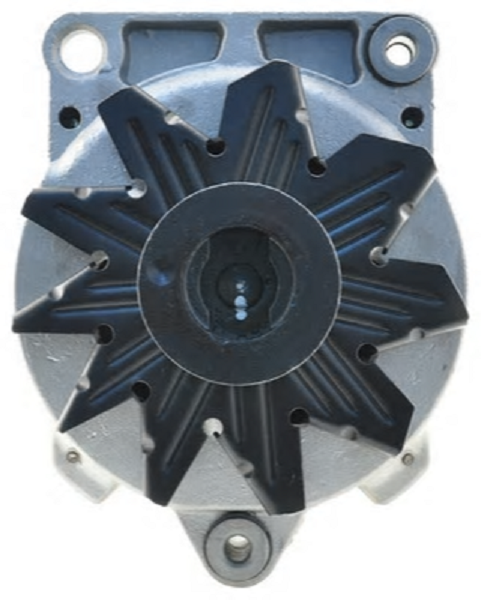

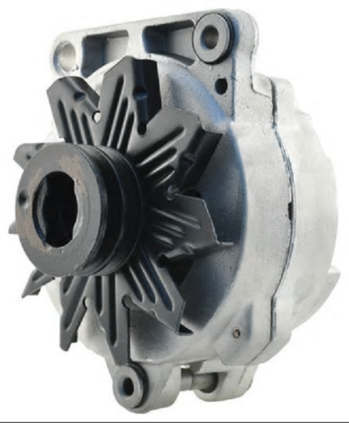

1,494
Is there any way to tell which alt is in it? Parts guy asked me if it was 100 amp. I have no clue.
The 100 amp alternator is huge (and heavy) and is reserved for cars with a lot of an electrical load (like police cars or cars with power everything).
The other 99% of us got the more normal alternator (not the 100 amp one)
The drive belts and pretty much all of the front engine brackets are different with the 100 amp alternator.

I'm very excited about going there. I'm picky about how I want the exhaust to look and sound, and Gary sounded eager to work on it. The price may be a tad high for supplying my own mufflers, but as you said...you get what you pay for.

Thanks, BudW. While removing my a/c compressor and finishing the new alt belt routing, I discovered my alt is the original 65 amp, dated 1979. :D
