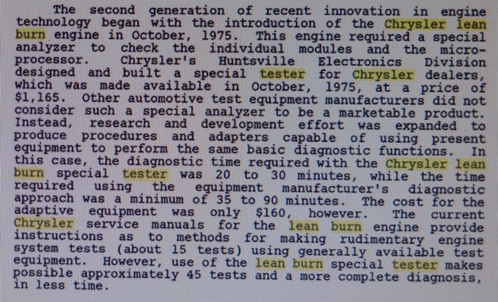

found this online.... There was one on ebay a while ago IIRC

I should also say finding a factory tester – that is still functioning (which both was a problem back in the 80’s) as well as the needed cables – was troublesome. Now days it is very hard to find a tester.

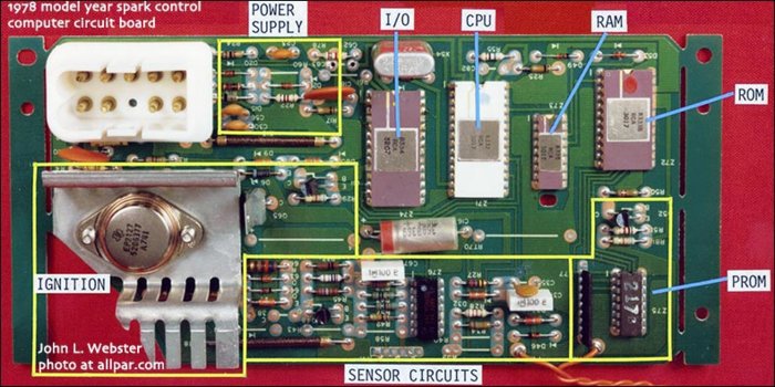

Hey BudW: Just out of curiosity, what do you mean by "Analog Computer"? The sensors, sure, produce analog signals, but so do (most) sensors on modern cars. In the case of Lean Burn, the signals are first sent to a sensor circuit and a digital I/O chip for conversion into digital interpretations for the CPU. Lean Burn units have integrated ignition, an I/O chip, a CPU, RAM, ROM, and even a PROM. The video below is VERY insightful into what Lean Burn is actually doing:

The LB/ESC has a microcontroller, which is a very primitive, slow computer, but it is digital. By the looks of the PCB, it looks like a 4 Bit CPU (same as would be found in calculators). It really doesn’t do that much, which, only taking in vacuum, RPM, temperature, and throttke position, and only outputs an ignition pulse. It probably can’t output diagnostic codes.
Modern automotive computers are mostly 32 bit, and must have 50-100X the RAM and Flash storage (equivalent to the ROM/PROM in the above circuit board). For things like adative cruise control, they are probably adding a DSP chip.
All signals from the various sensors are analog. The real world is analog in that it doesn’t change in steps (think temerature, air pressuer, coolant temerature, etc.). The analog signal is converted to digital (by A/D convertirs) so that it can be input into the digital CPU and the software can work with it (same is true for the LB/ESC computer).
Analog computers can be made, and they are in use. But the can not be programmed, and they are for very specific uses, and are not generally used.

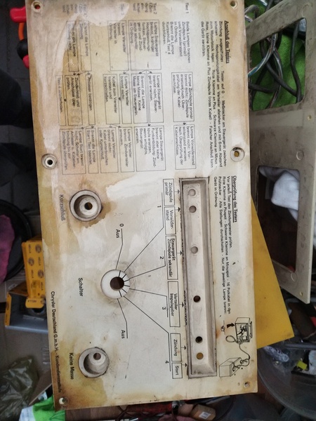

@BudW - are you talking about one of those diagnosis testers? It is labeled in German (just a glued on faceplate), but I think you get the idea. Its a ignition tester, and I also have the adapter for the 5pin ignition connector.
By any chance, do you have some wiring schematics of this? It is working (using the self test), except for test 1 (primary coil and ballast resistor) - it fails with signal "short".
I'm going to check the cable first.
1,492
That is one of the several factory computers we used. No, I don't think I've ever seen a schematic on one. Cables were treated rough by the different techs and a common problem area.
I've worked on a few PC boards - but, honestly, never looked inside of one of the Chrysler testers.
It does make sense to make a single tester, then slap a different label on it for different languages.
