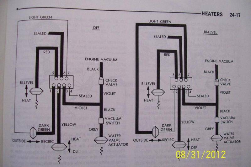

Aug 31, 2012 #1 F furyfrank Well-Known Member Joined Jun 27, 2011 Messages 263 Reaction score 4 does anyone have a vacuum diagram for the a/c-heater controls ?:help:

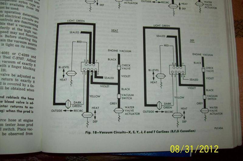

Aug 31, 2012 #2 jasperjacko Well-Known Member Joined Dec 4, 2011 Messages 1,671 Reaction score 251 This should help
