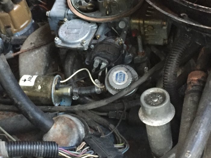

I will take a photo or two and post here.. There is a lot going on in the engine room, and my I want to learn my way around.

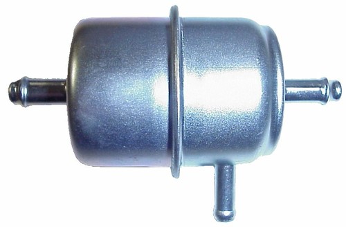

If car is using a 3-prong fuel filter or has a provision for excess fuel to return to fuel tank, then (in most cases) fuel percolation (vapor lock) shouldn’t be an issue. Again, underhood pictures will help with that.

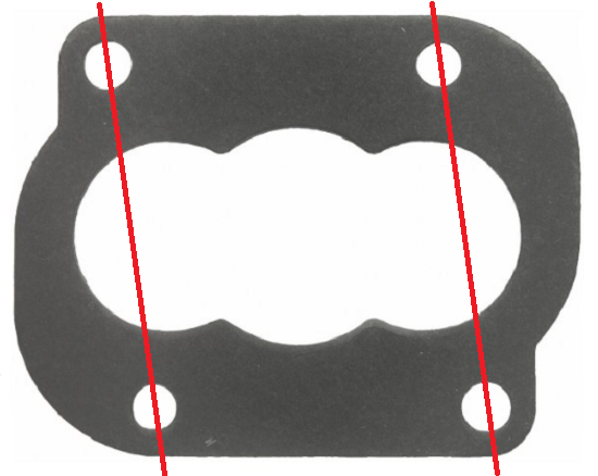

The intake manifold has an odd bolt pattern to it. It is the same intake used for ‘87-91 pickup/van/Dakota fuel injection – so if a person really wanted one, they are still out there to be found. Otherwise, boat anchor, door stop, etc. are good options. The other fuel injection parts are sellable items – for someone still using the factory setup. I wouldn’t expect a lot of money for parts, though.

I've just learned about the fuel filters with a return port. That may be useful. I was thinking there was a return line to the fuel tank. When I was rigging up a temporary fuel cell to drive the car home, I noticed what looked like a fuel line that had a bolt stuffed in it, right next to the fuel line.
The fuel filters (there are 2 in parallel below the passenger door hinge) may or may not have the vapor return port,I will find out tomorrow. The fuel tank has who knows how old gasoline in it. I have jacked up the rear, and intend to drain the tank via the fuel line at those filters.

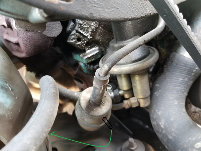

Below is my first attempt at attaching a photo of what I am calling the fuel pump and pressure regulator.
I am willing to donate the fuel injection parts, IF someone wants them, but at present they are on the scrap heap, and I am assuming it was removed because it was not working as desired..

Good point, and good information. It seems to me that the ideal solution would be to put a fuel pump back by the tank, and then the carb fuel bowl is refilled when the key is turned on.. allowing 87 Octane. I have NO issue with running non ethanol fuel, but the only stuff sold around here is Super Unleaded, and if I am spending the extra coin to get good fuel I want a motor that has enough compression to need the good stuff...
Bud informed me that the factory had an in tank fuel pump. I will go looking around for it today as I would like to drain the old gas out of the tank... Maybe I can re-engage it, with a pressure regulator, and the problem is solved. More questions to follow I am sure.

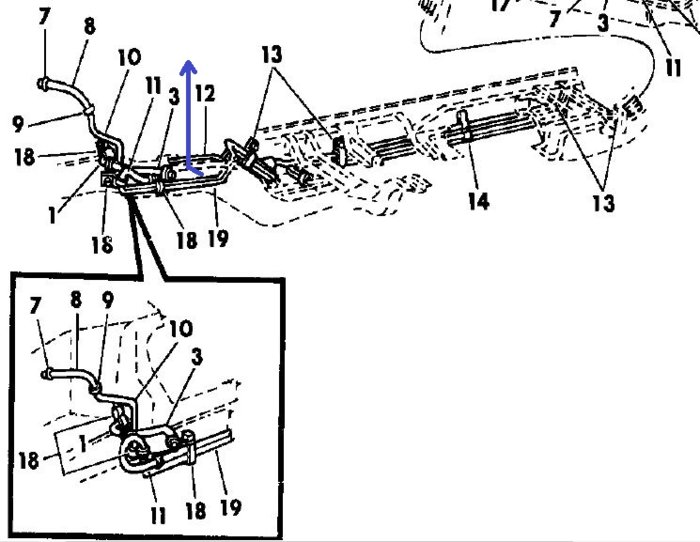

The fuel injected Imperials used two fuel filters in parallel (has two “Y” fittings, one before and one after the filters). There is no reason to change it to a single filter, unless wanted to take some extra work to change it over. Dual filters won’t hurt a thing.
All the carbureted FMJ vehicles had three metal lines running from front to rear on passenger side (under floorpan). The two-door cars are a bit shorter than 4-door cars are, but otherwise the three lines are the same for all FMJ’s (except for yours).
5/16” is fuel supply line.
3/16” is fuel return line.
Both line nipples are under the alternator area on frame rail.
1/4” (aka 4/16") is fuel vapor line. This nipple goes a bit more forward and connects to the black charcoal canister (by radiator).
The black fitting (hard to see) and green arrow is where fuel return would go on a non/FI car.
In the rear of car, the two metal fuel lines connect to the fuel sending unit on fuel tank. The fuel vapor line most likely connects to a fitting on top side of tank (the fuel vapor attachment varies between the years).
On the L/F frame rail, close to the firewall (under car – same area as your fuel filters are currently located at) there are three (additional) rubber hoses. One for each of the three metal lines.
The Imperial fuel lines (both) then go up along the firewall (blue line, above picture). All other car types, the fuel lines go forward along the fuel rail to the fuel pump area.
If you are considering replacing the electric with a mechanical pump, you might want to either bend the lines (or run new metal lines) from fuel filters area. The mechanical pump area is not ideal, but I’ve seen a lot of cars that have installed electrical pumps in same area (under alternator). Either way, that location is still better than up high like that. Then purchase a small block fuel line (used or whatever) and adapt it to carburetor or make a new metal line for that as well. That would simplify the carburetor area, a bit.
There should be a metal box with wires coming out of it, attached to the fuel line, that some might think of a fuel pump (at first glance), that counts how much fuel is used and reports to the dash. It is part of what is needed for dash to work correctly. This item needs to be attached to fuel line after return fuel attachment.
