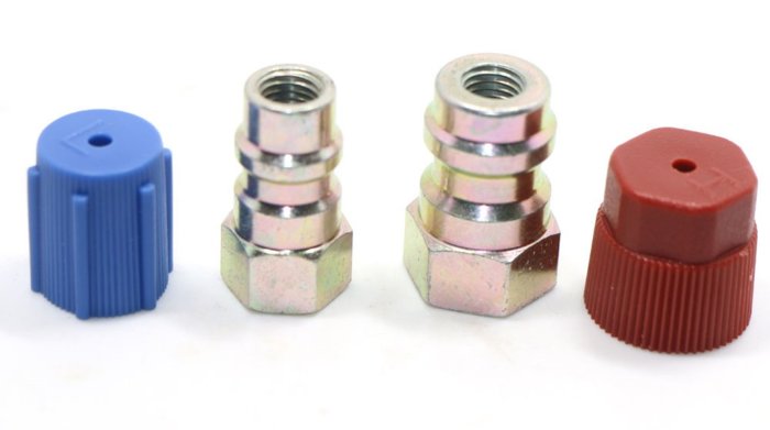

Part of the conversion, was the R-134a service port tap kits (which I think is what Justwondering might be talking about) which I got from my local parts store. I screwed the first retrofit port on top of the existing R-12 port on one of my new hoses. Twisted a bit too much and tore the existing port right off my brand-new hose. I ended up taking the original hose and flushed and reused it (after purchasing another R-134a port retrofit kit). Man, I was not happy about ruining a new hose, like that.
The A/C service ports (R-134a retrofit) look like this

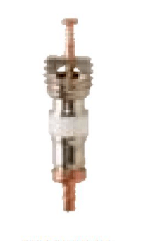

The valve core for the service port looks like this (pretty close to what a tire uses).

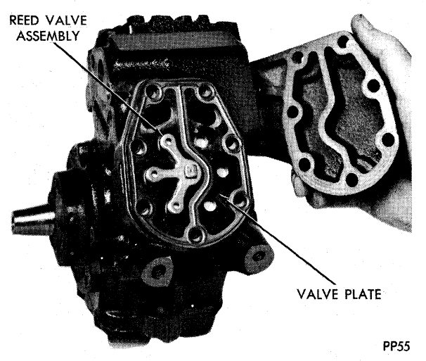

The A/C compressor reed valves look like this:
Three reed valves on top and three more on bottom (intake and exhaust). This is from the cast iron RV2 design, but the Aluminum C-171 design is similar.
A/C compressor reed valves do fail (as well as other things that fail inside of an A/C compressor) – so not sure which valve Justwondering is referring to, exactly – but any foreign material inside of A/C system besides refrigerant and refrigerant oil will lead to a part failure.
