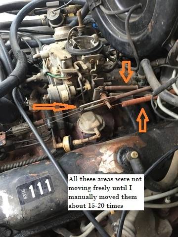

I just was outside and decided to start the 87 Fifth Avenue since I didn't run it for the past 48 hours.
Gas pedal was sitting high, one push, it stays on the floor and barely recovers.
Won't start.
Obviously not getting gas.

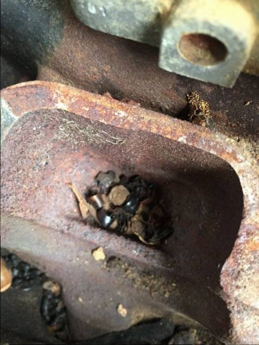

I pull the air filter off and decide today is the day to check the choke thermostat. I bought a new one couple of months ago.
I bought the wrong choke thermostat. Old one has no wire, new one has a wire. I think it needs to be someone elses. Can't return it.
But, I did remove the old thermostat and it seems to be flexing quite nicely. The problem appears to be the bug carcasses in the curved bowl it sits in. Cleaned out the filth. Disgusting.
Put everything back and it seems like it flexes correctly.
So I check the springs on the other side thinking that one is broken or not connected.
Everything is fine.
But I notice all the rods, brackets, swivels, have lots of surface rust. Pushing the pedal not much moves.
I use my hand and move the rods back and forth, remove the springs and reattach. Move the rods. Move the cables.. until it seems like things are moving more freely.
Sure enough, the pedal now responds correctly.
Tell me what I do now. I know if I leave it, the rust will return. I don't really know what was stuck/sticking. I just know its working better now.
Do I take things off and sand the rust off, scrape it off, chemically remove it?
How do I make sure the rust or gunk doesn't inhibit it in the future?

On my '52 Ford flathead, all of the carb linkages were seized up from sitting 30 years. I started soaking them in some PB Blaster, and now they move fairly well.

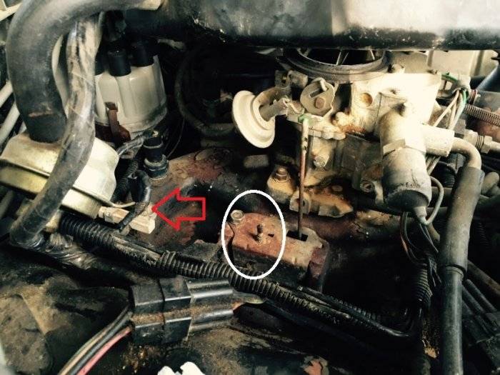

Your old choke thermostat has had its wire broken off (from seeing pictures from earlier). The replacement should be the correct one, as long as rod looks like is bent the same (the other two versions are bent way different (4 bbl or /6).

The linkage was designed to be operated dry. WD40 (and other products) works on preventing rust. The best cure is to drive car every so often.

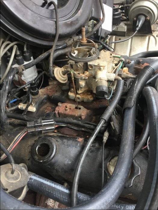

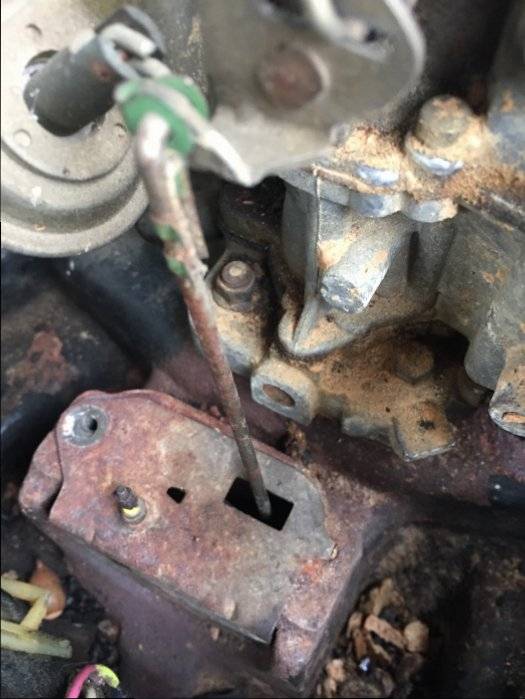

Before I started...

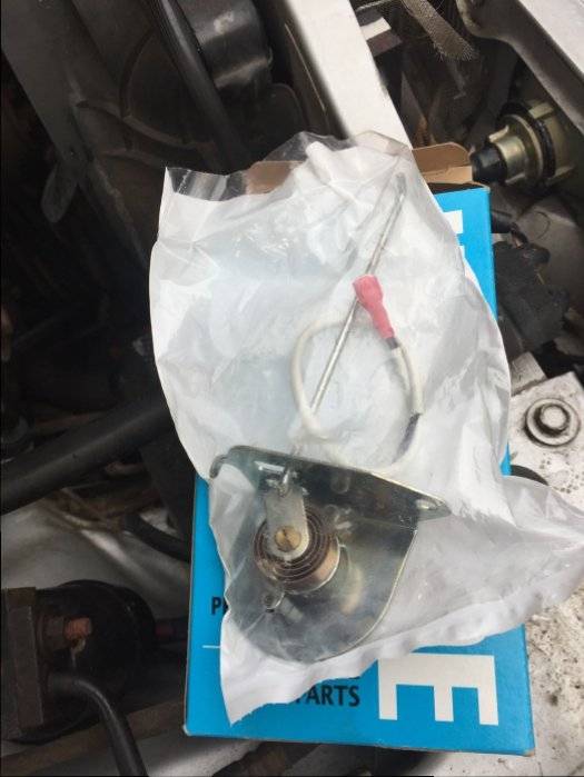

What I purchased ... note the rivet at the bottom of the spiral -- this hits the 'well' and doesn't let the part sit like the original.
I had just removed the bolt from the left side. And yes, I need to get the air compressor out again and blow the filth off the engine block. Sigh.
Dead bug carcasses and leaves and filth ... I swear I didn't know there were so many places for gunk to be deposited.

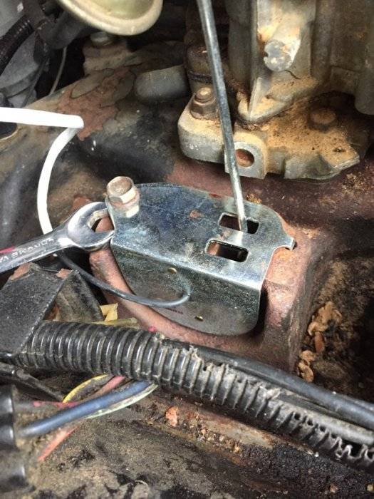

'Well' is cleaned. You can see the ridge at the bottom of the well that the rivet hits (new unit).
I put the old choke thermostat back in. I'll need more help to know where it plugs in. I could use the new one if its okay to put a spacer under the bolt and not have it sit all the way at the bottom of the well.

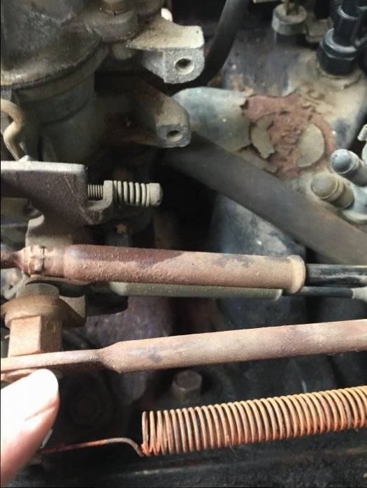

Push and pull on all the cables, rods, and springs on the other side.
Is it okay to spray dry lubricant on these parts?

Justwondering, I mentioned to you some time back that your thermostat heater wire was broken off and a new thermostat should improve your cold start ability.
The white circle is the missing wire. The red arrow is where the wire attaches to.

You can use pretty much what you want on the linkage. Normal usage should keep any rust worn away (dry). Avoiding using something that attracts dirt (like grease) for dirt will cause wear and jams/sticks. Something like WD40 or the like to help prevent rust, is all you need.
If linkage still feels like is binding, then I suspect the problem is linkage down by the transmission/starter area.

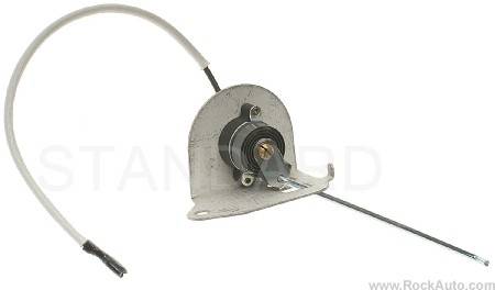

Here is the image from Rockauto:
Here is what the original looks like:

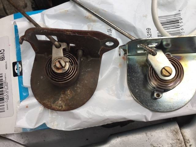

Here's my comparison of parts
I did install the new one and it sits about 1/4 inch too high. About the height of the box wrench

That one would work – but I wouldn’t spend $60 for it.
I’ve not seen that ridge in the thermostat cavity like that before.
Grinding the cast iron will work - but that will be a really not fun job to do.
The choke thermostat rod length is different between the Carter BBD vs. Holley2280/6280 (they look the same, but sitting side by side shows they are different) – so I removed the one from my ’86 5th when I pitched my 6280 and replaced with a ’77 BBD.

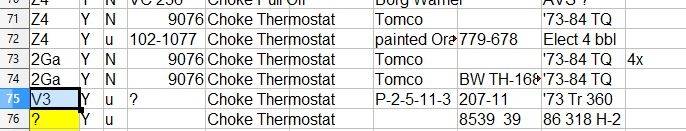

The old choke thermostat is on this snippet I took from my files.
The last entry is the one I'm looking for.
The Yellow ? means just that. I know I have it – but where. I think I know but hadn’t gotten there yet.
