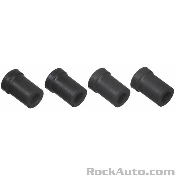

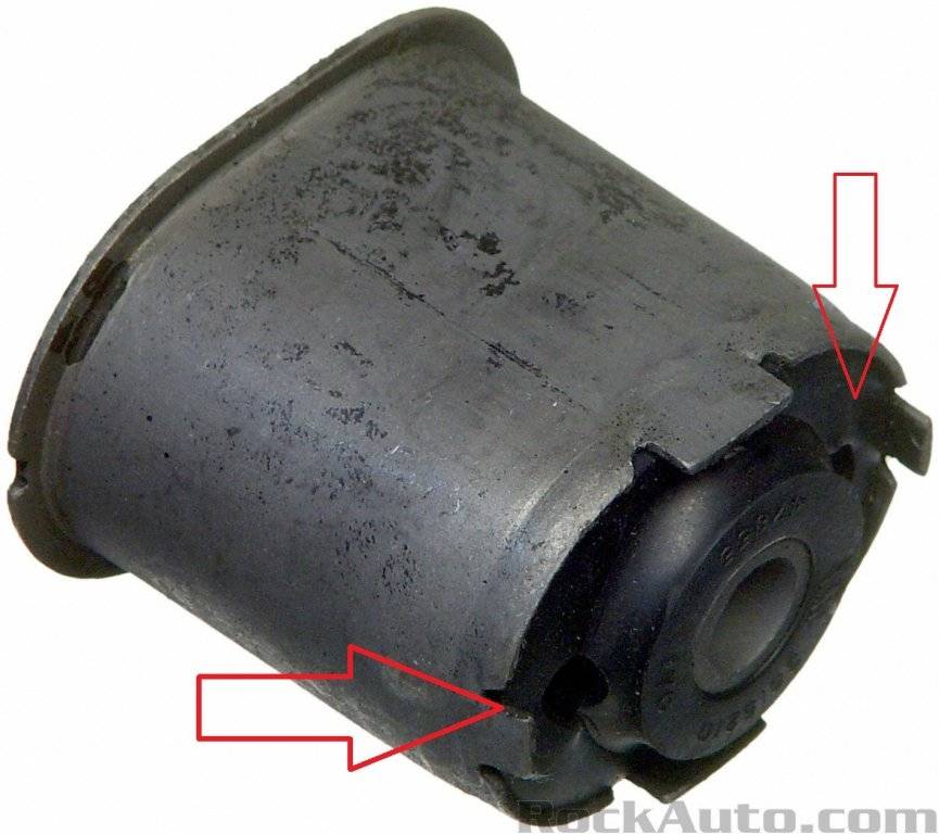

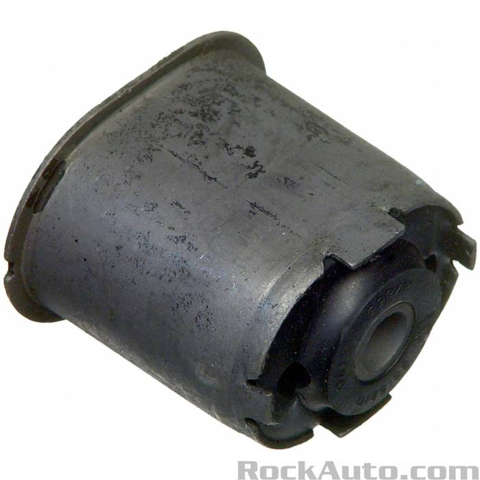

LOL! Thanks bud, they did not specify on the site.. Just leaf bushing. I figured perhaps it may have been a different leaf on a different optioned car or something eh? well that answers that question, thanks.
1,492
Bottom picture is for front leaf spring and top picture is rear leaf spring/shackle.
You will need two of each part number.
1,492
Not a problem.
I just purchased (a month ago) enough bushings to replace on both of my cars.
Now, I just gotta get ‘em done.
Note: you need a press or something similar to change those front bushings.
I have a 20 ton press (a bit of overkill in this case) and a smaller gear driven bench press thing that either would work.
The rear bushings are fairly easily. The front ones, not so much.
For my personal cars, I always add studs or bolts/heads cut off, and insert into the holes on front bushings and make them a bit firmer.

Can you be a bit more specific on "both"?
I see a few possibility’s as to "both" in this thread.
I'm putting the bigger springs in my car and need to put new bushings on the front and back. I was just going to hit PEPs or AZ and see what they had or try polyurethane
1,492
Rear bushings
MOOG part number K7308 (one set per side) rubber
Front bushing
MOOG part number SB364 (one per side) rubber
FYI: both bushings also fit my wife's 2002 minivan
The front bushings generally require access to a press.
I don't recommend polyurethane bushings for leaf springs because of ride harshness. You need a little something to cushion bumps. Poly transmits ever single hairline crack in road, and every dustmite you run over, straight to your kidneys.
My recommendation is if you want to firm the ride a bit, then insert metal studs (or something) into the two holes in the front bushing.
