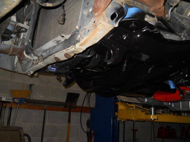

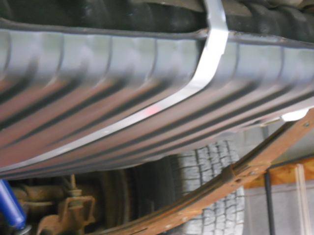

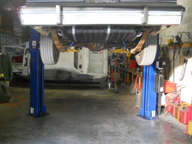

Here's pretty much what all I had to do to shift the tank over:

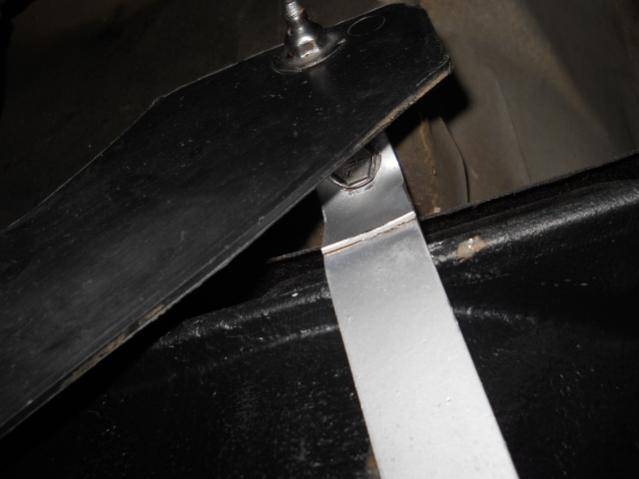

Fold over the edges where the straps go...you can see to the side of the strap where it originally was seated:
With that you should have enough room to pull the strap around and bolt it in. It's tight on the driver's side since it goes around a bulky area of the tank but it will go. The bolt doesn't seat flush into the clip but it's tight enough.

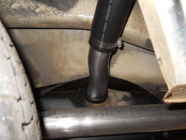

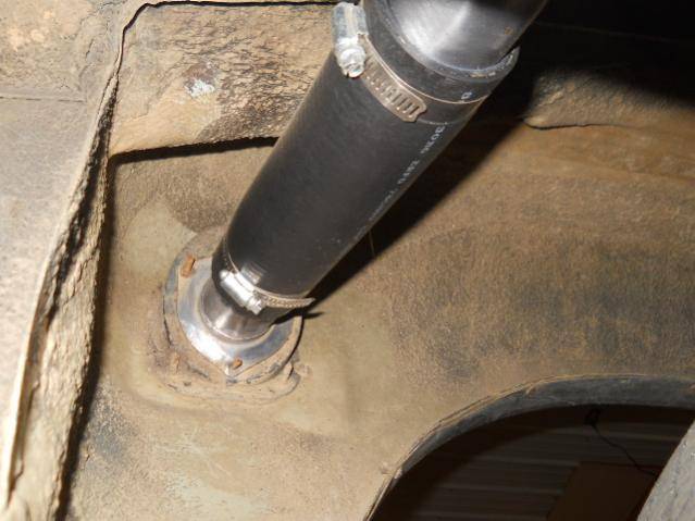

You need to cut and lengthen the filler neck with 2" gas hose. I also popped in a new grommet:
The tank shifted over makes room for dual exhaust but even with 2.5" tubing it's tight on both sides.

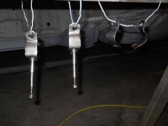

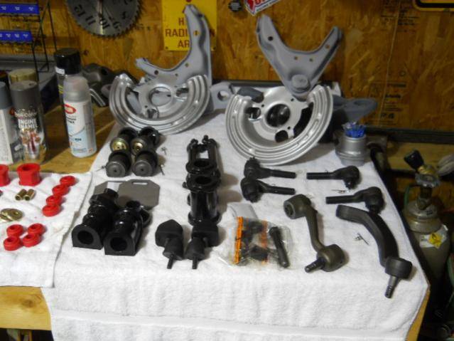

Here's most of the parts to rebuild the front end. I'm waiting to put the ball joints in before I paint the control arms. Some of the parts I just sprayed with a satin or gloss clear over a clean "natural" surface...like the pitman and idler along with the sway bar brackets.

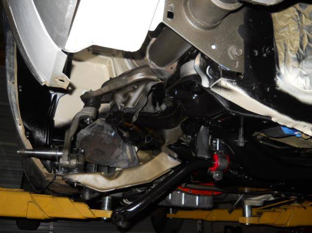

Work has kept me pretty busy but I have the front end almost completely together.
Everything I could clean and repaint I did, including the bumper shocks or whatever those things are called.

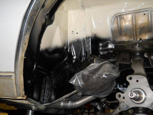

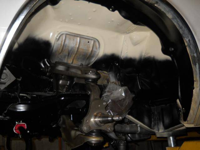

I repainted the inner fenders, The messy black overspray was like that and I tried my best to redo the factory look everywhere it originally was...so it wasn't just me being lazy and sloppy:

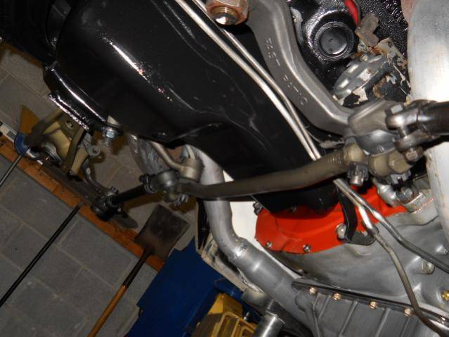

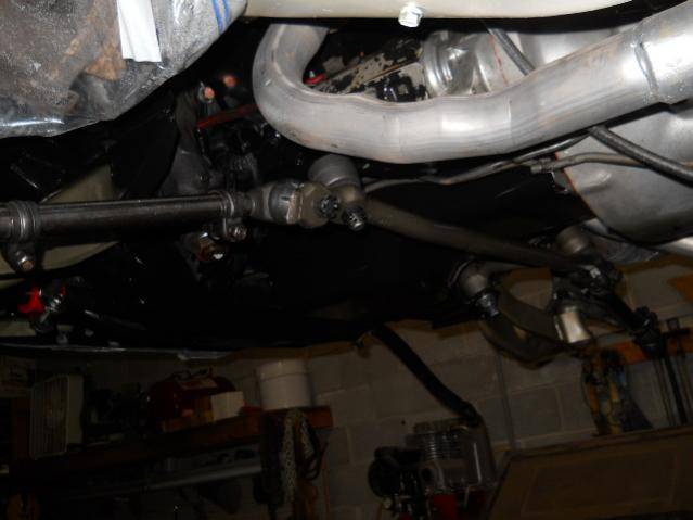

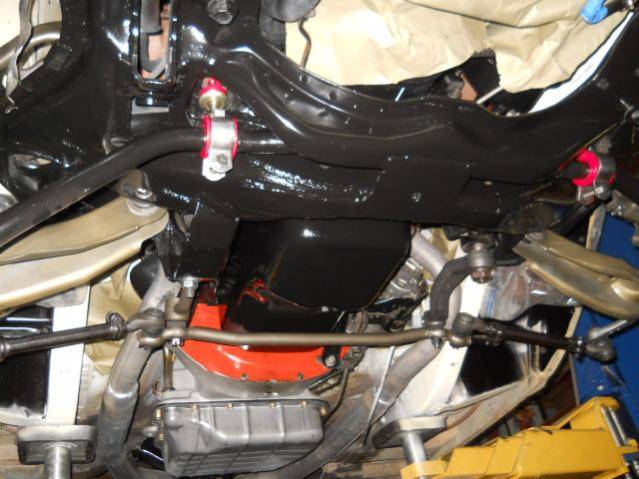

I have the tie rods mocked up for the time being. I had to ding over the exhaust pipe a little for the fast ratio idler to clear. Pitman looks like it will be fine. Not sure why my oil pan looks streaky in this picture, it must be a reflection of something:

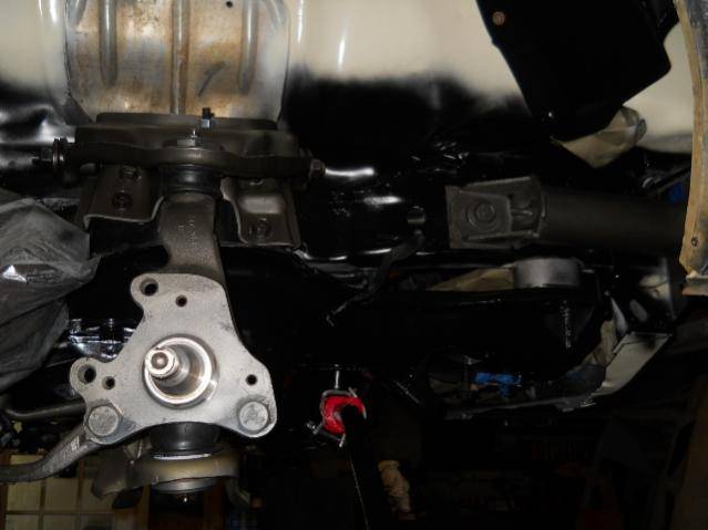

This is where I got to before I was ready for the torsion bars:
