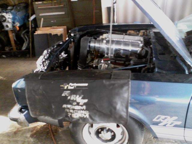

Had a Duster in my shop for race wiring and plumbing. Front end was missing. Hopping in and out of the car, the body lines look very similar from this 1970 Duster to my '80 Aspen. Aspen needs to go on a diet before the BB goes in. Can't find any fiberglass parts. Swap do-able?
