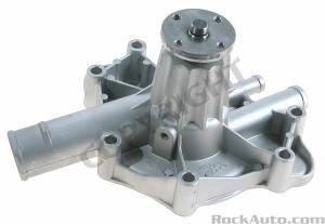

Use a shorter single belt from the crank pulley to the outermost groove on the alternator. File this rib on the water pump for added belt clearance.

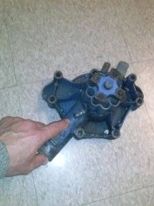

That water pump looks a little different than mine. It looks like it doesn't have that tab like the one in the pic.

No I have a SB. It just seemed a little different, because where that tab is there are two little ridges that blend into the housing from the pipe.

Chrysler had two different water pumps for 1970-1991 small blocks, the heavy duty one was higher volume and had larger bearings. The one pictured is a standard duty pump.
2,992
Keep in mind also, aftermarket pumps of different brands won't necessarily look the same either. Heck, I've seen aftermarket pumps of the same brand for the same year, make and model of vehicle look totally different.
