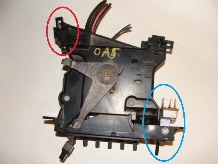

There are two different issues here at play.
The first one is the difference between “A/C” and “Max A/C” buttons. The difference there is the A/C control head turns off the hot water valve so the heater is out of the loop/out of play in this case when “Max A/C” is turned on.
If A/C only blows cold in the “Max A/C position, then your blend air door (or in case of SATC, the servo motor) is not working correctly, stuck or disconnected.

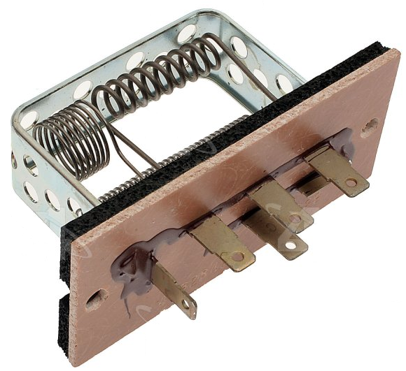

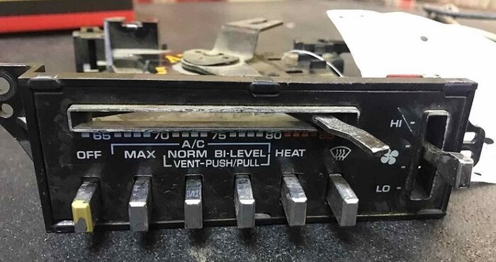

The next issue is blower speed(s) – blue circle (below).
If blower will only blow when switch is full up – then the blower switch or blower resistor is bad, or wiring connector to the resistor is disconnected.
The blower resistor

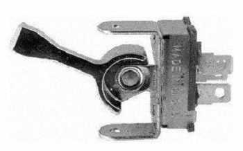

The blower switch has two small screws that hold it on (one top and other bottom). The switches come with a chrome lever or a black plastic one. It will work with either handle – but it looks goofy when you do that.
Most blower switches can be replaced after the A/C control head is unscrewed from dash and pulled out a short distance.
The blower switch and blower resistor are both available aftermarket (new).
