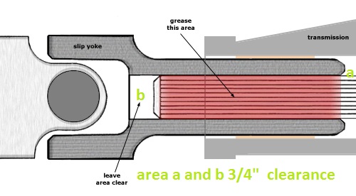

Hmm, many different people posting with different vibration issues. Perhaps "clock" the driveshaft. Unbolt the U Joints straps , pull the shaft out of the trans, rotate 180* and reinstall into the trans and bolt the assembly back in. 180* off of what it was......
check yoke engagement too.
