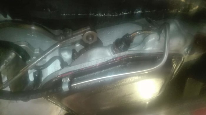

Would ATF Dextron 2 be good to go for a a904? Last time I did replace it with this type of Petronas.
I want to replace one of the cooling lines to the transmission. One looked bent and seems to smother the lead. I can't found one for sell. On the car the tubing from the transmission and radiator are connected with a fuel hose (8mm). So would replace only the one in the transmission.

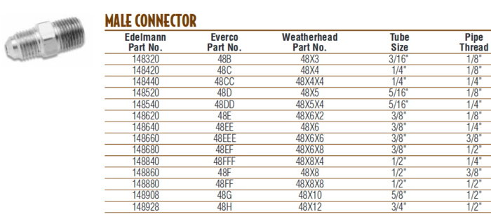

I saw that the connector in the trans is 1/8 npt to 1/2-20 fitting. Like a 148520 Edelmann. This one is good. But looking for a 1/2-20 nut and some 1/8" tubing (stainless?)?
2,991
I would try to find something the same as Mopar ATF+4. It would say it meets ATF+4 specifications on the bottle.
You can get new pre-bent cooler lines but only for V-8, far as I know.
The trans cooler lines are 5/16" and you may need to use the old tubing nut over. Finding a female thread tubing nut is tough, from what I've found anyways.

Okay thanks! I would see if there is a supplier for 5/16" brake lines here.

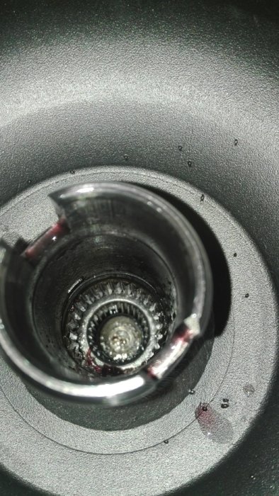

Today I did bring the torque converter to a transmission specialist. He did a quick look inside and came to the same guessed conclusion that the splined in the turbine is gone. So he would split the converter and replace the needed parts. He also notice that he doesn't have seen before that the splined got crushed and caused a non drivable car.
I am still wondering what caused the broken splined connection to the turbine.

Saturday build in the transmission with the rebuild torque converter.
They have welded a new 'heart' with a splined hole for the turbine. They have also installed new bearings and a gasket lining for the lockup.
There was now a limited distance when mounting the converter on the flex plate. Made a new stainless steel 5/16" cooling line for the trans that fitted well.
