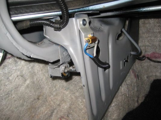

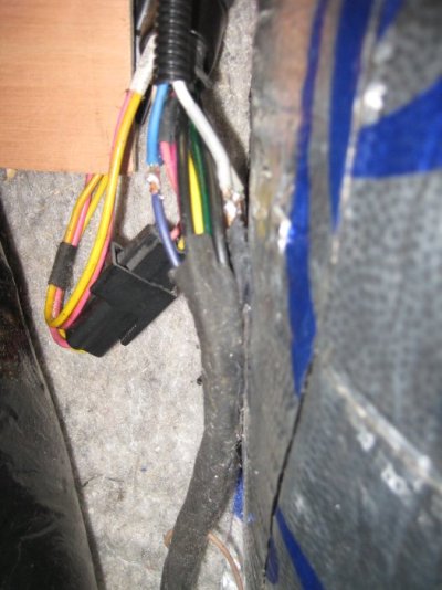

Below is a picture of the resistor I mounted in the trunk for easy access in case I want to substitute a variable resistor to 'fine tune' the fuel gauge readings. The other picture shows the wiring harness behind the rear seat back, drivers side. I tapped into the original dark blue with black tracer (DB / BK) and grey (GY), wires. Solder joints have since been coated and wrapped with electrical tape. Apologies for the blurry image, auto focus on the camera is a little too sensitive.
