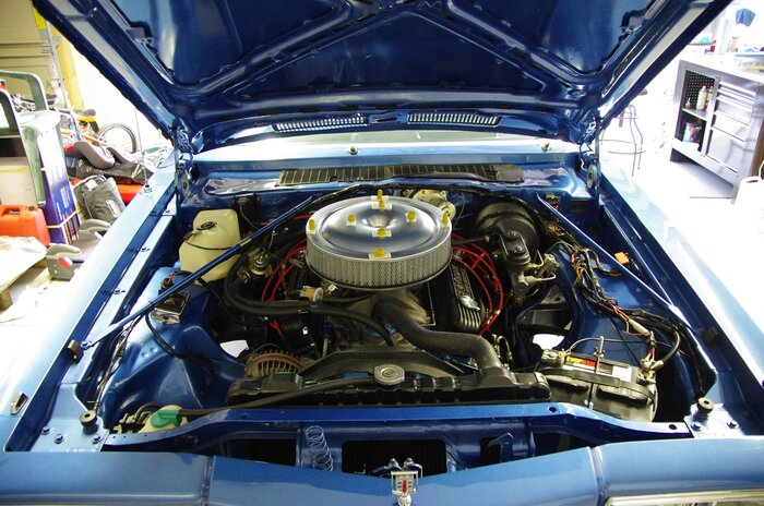

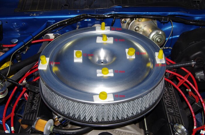

So the clearance is party driven by the sizing of your air filter, as well as the shape of the air filter assembly.
I ended up running a drop-base 16" diameter setup (WIX filter) because I needed extra room for the square to spread-bore adapter on top of my Performer RPM intake where my Carter TQ sits.
Let me know if you need part numbers, but again, these are going to be pretty specific to your combination.

Thanks for the info. Appreciate you adding pictures. Super clean engine bay - looks really nice. I like how you checked clearance.
