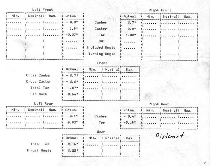

Here is the final result from yesterday. He didn't bother putting the hats back on as he felt he was correct yesterday....

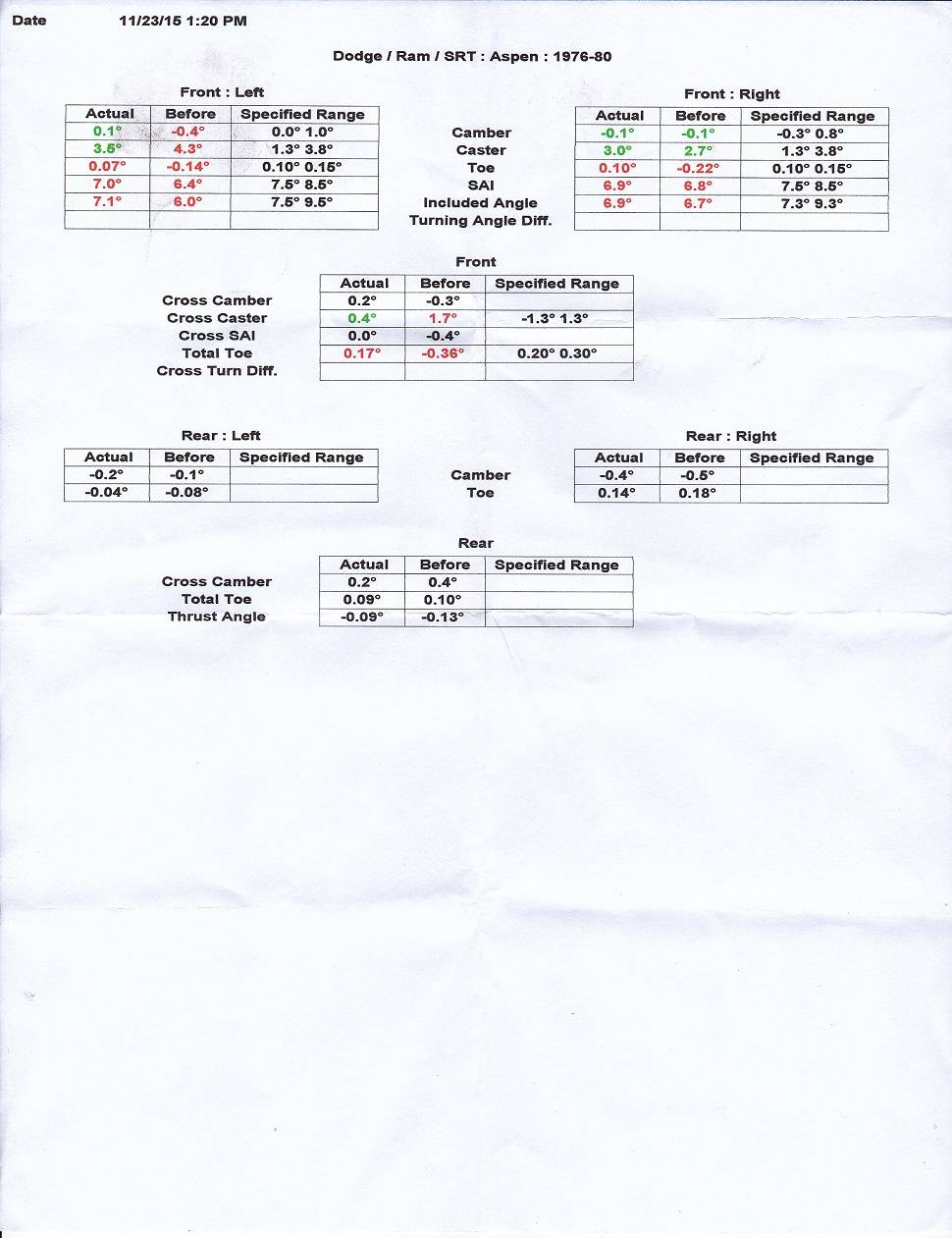

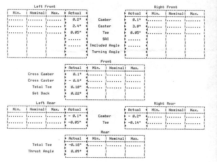

So here are the BEFORE & AFTER alignment metrics for my '80 coupe...keep in mind, the BEFORE stuff is really a DIY garage stuff, just visually and tape measure type check...the AFTER on the other hand is what the shop felt was going to work best with this car...LOL...they did bring out the "old geezer" for that job...and he enjoyed doing the car and basically "shooting the shit"...part-owner of the shop, I felt comfortable having done my alignment there for the daily drivers...result is: car handling has literally nothing to complain about...handles great (as far as M-bodies do), all new suspension pieces, poly bushings, KONI adjustable shocks, big sway bars, etc, etc..
BEFORE
AFTER
