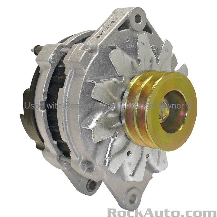

Yeah mopar has 1 ear and two bolt holes, but I'm not an expert. It's what's on mine

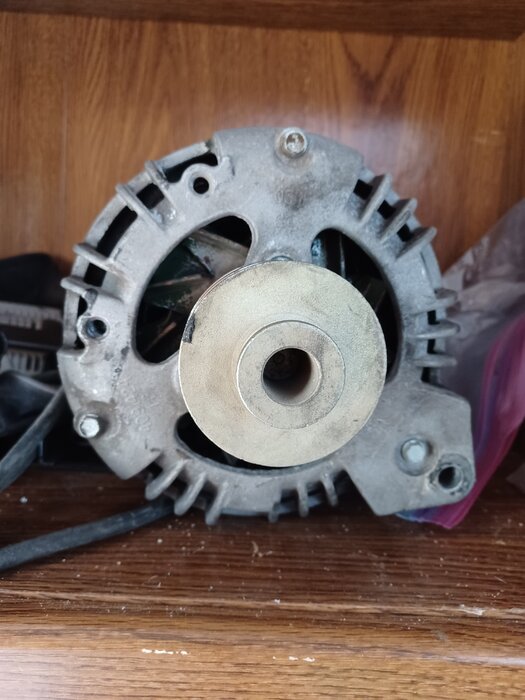

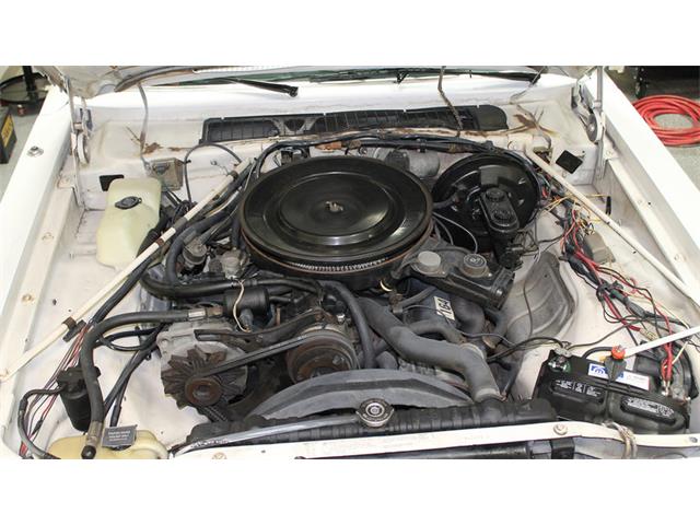

View attachment 50910View attachment 50911
What year is your Diplomat? Curious when/why they changed the brackets and alts to GM set ups. Then again there’s a number of GM parts on our cars, wonder if that was just a cash saving option instead of developing/making shit in house.
AMC Diplomat
Feb 14, 2023
1,682
793
NY

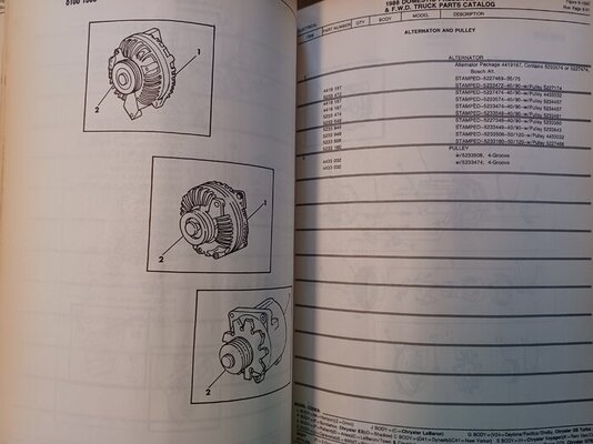

Mine is an 87. It actually had the wrong mopar alternator on it when I got it. It cross referenced for a truck. I have a mopar remanufactured alternator on it now. Not that it matters too much. That style of alternator was used for decades in all different vehicles.
Yours had a GM in it? I didn't know that was a thing. I'll go look in my parts book from 88 and see what it says

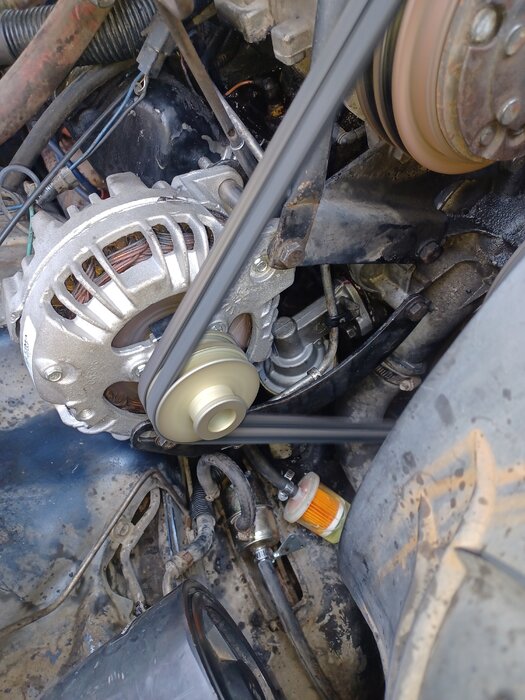

Yea, with the bracket tensioner on my car, there’s no way a traditional Mopar one can go on. Uses one (top) dog ear for the tensioner and the other (bottom) to hang from the block.
I’ll take a photo never time I’m out in the garage.

Those pictures are the typical mopar alternator used for decades. If that's what you have you need the mopar bracket.
I don't know the CVF stuff but my guess is the GM bracket is for people who are literally using GM alternator.
88/89 went to the Denso alternators that use the bigger police bracket but with the tensioner bolt added to it.

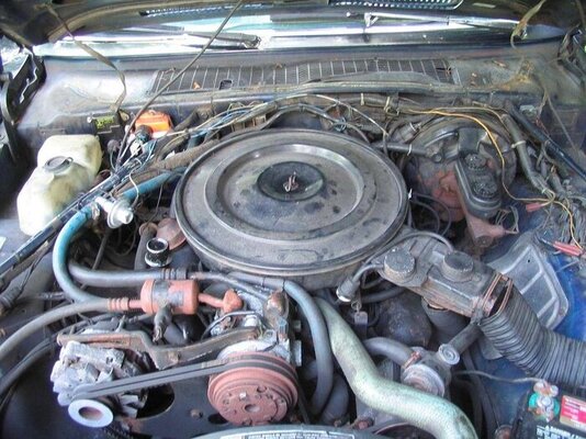

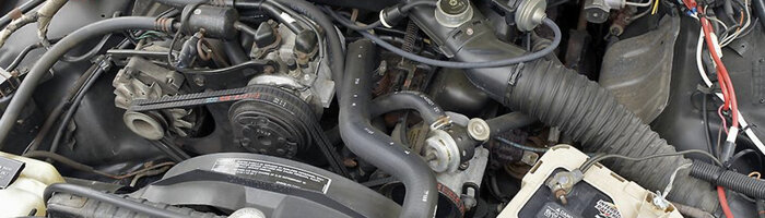

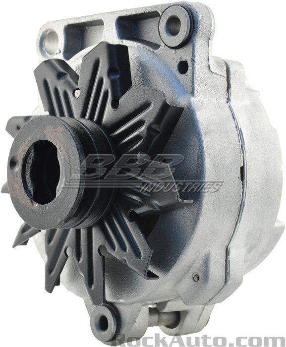

This is the set up on my car (not a photo of my car)
Mikes5thAve
Mar 3, 2020
1,791
745

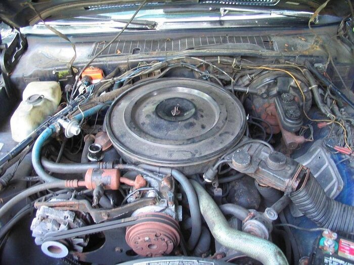

That's the later HD style Chysler alternator it's different then GM. They've used those square body alternators with the different bracket setup since the 70s. This is the older version
Mikes5thAve
Mar 3, 2020
1,791
745

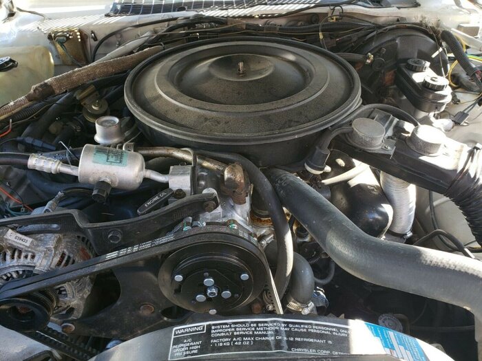

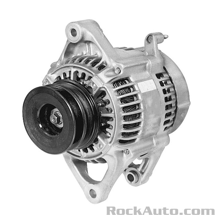

This is the 88/89 version
And the Denso (rounded one) that they gave up the old style alternator for. They all use thst different bracket setup.
Im guessing that you would need the GM style bracket but might end up needing spacers.

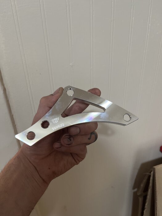

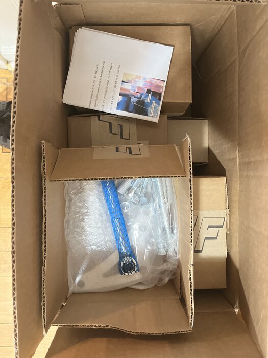

CVF parts arrived this morning. My suspicions were correct.
If you have the HD alternator and bracket, you’ll want to select the “GM” alternator bracket/adjustment rod option, if you have the standard Mopar round alternator with the round/square back you’ll want to select the Mopar alternator option.
All spacers and hardware included, made in the USA out of aluminum, part and manufacturing ID cut into surface…do you need these on your car, no. Do they look nice as all hell, you better believe it, Scooter.
Gonna clean up the engine bay real nice.
