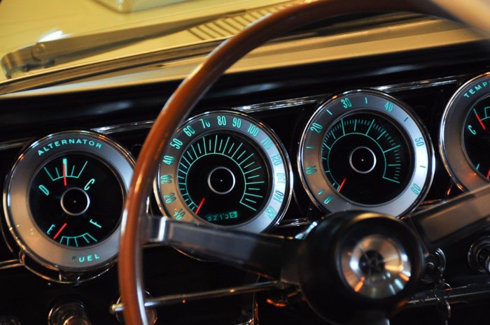

Note: the ’66-67 Charger gauges are unique in the fact the gauge face is electroluminescent (the backlighting is attached to the metal gauge backing with a black sticker placed on top so it glows through the sticker) and gauge dials are miniature light sticks. A very cool setup - especially at night.
