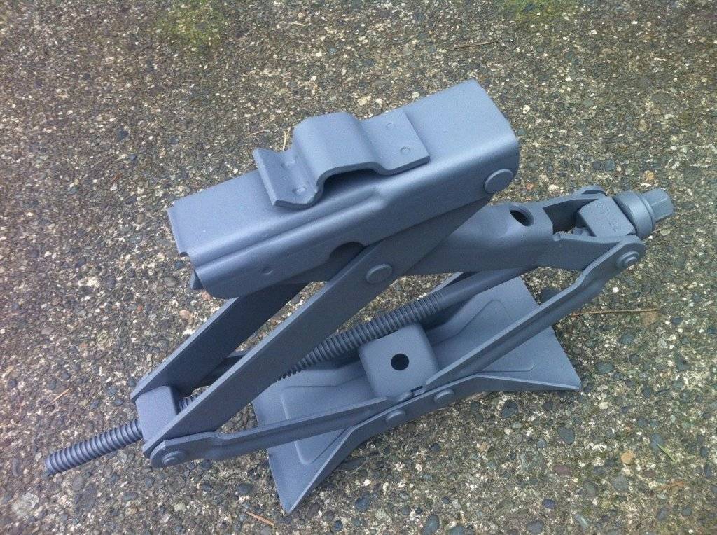

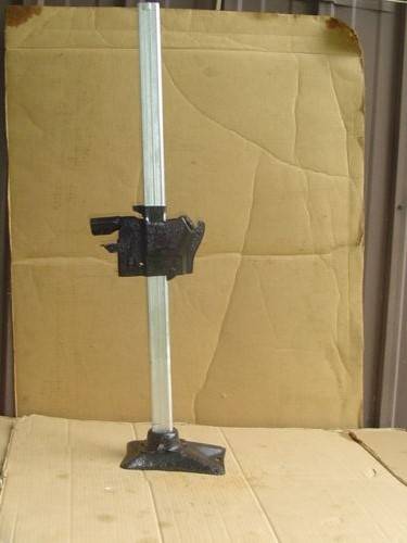

All of my J bodies have their original screw type jacks. I don't know what long travel means reagarding actual amount of travel, but they do seem to be able to go from almost flat to fairly high. I'm pretty sure the screw jacks were factory standard, at least on the J bodies.
1,492
The scissor style jack is much safer to use than the bumper jack is - by a huge margin.
In ’78 Chrysler started to change over from bumper to scissor style jacks and by ’80 everything had one (except pickups).
I’ve seen at least three dozen different styles from Chrysler and even more from other manufactures.
In my opinion is a design that straddles the rocker panel pinch weld is the best for our cars – but any of them will work.
Example pictures were swiped from the internet.
