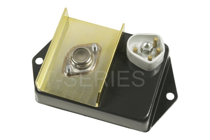

    - ICU (Ignition Control Unit)

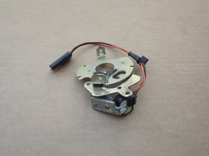

    - Pickup coil
