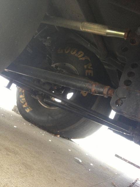

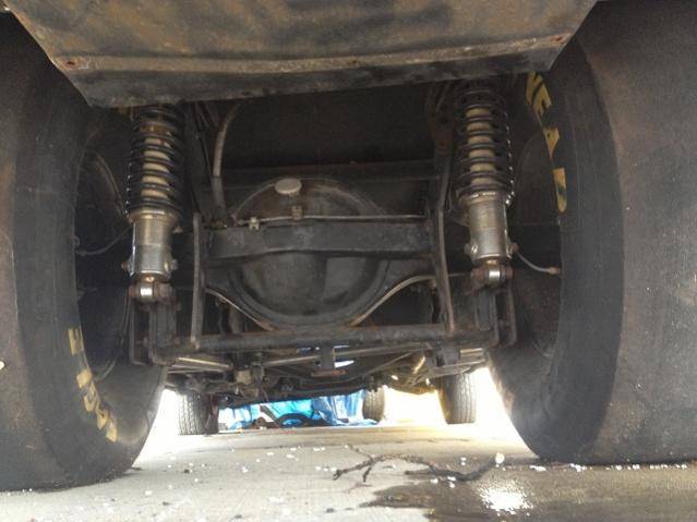

Got a pic of the 4 link?

Standard 4 link with coil overs and pan hard bar. 17X33 slicks on a 15" rim.

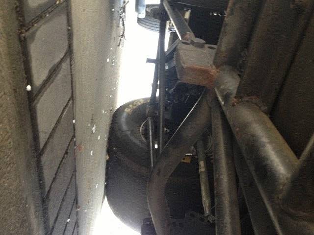

Some questionable welds and fabrication! Mainly the lower front mount of the lower trailing arm. The attatchment point has been butt welded to lower the point of attachment.

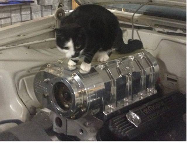

Some of you know that I bought this car as a rolling chassis. I plan on installing a 360 stroked to 387ci and running an 8-71 blower with a shot of N20.

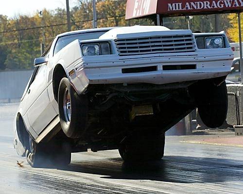

Awesome wheelie! What is the weight of your car?
The back halfed car will tip the scales at 3800 pounds too. These things are heavy. The 8-71 blower setup will add over 100 pounds to the front end. I want to convert to struts or coil overs. And set the engine back around 8 inches.

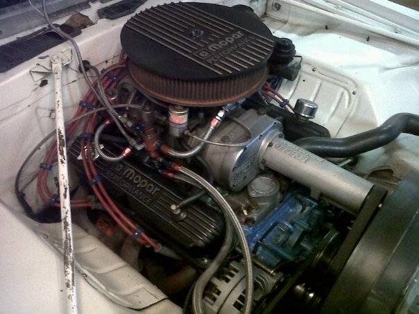

B+M 174 blower with a NOS Cheater system. I ran 6PSI of boost and upto a 150 shot of spray, anything more than that and the rotors would stall. The 6 rib blower belt wold slip.

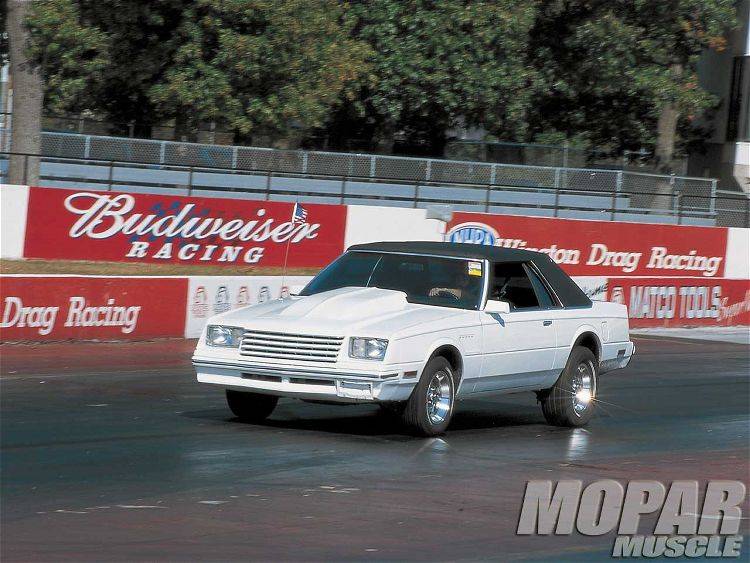

I'm guessing the white top car I'd fully caged?

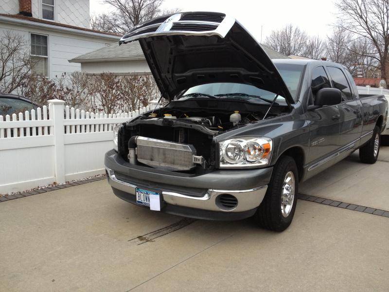

And since were on the subject of superchargers/prochargers, how do you like the procharger in your ram? Looks like a 5.7? Thinking about getting a procharger for my 99 ram after I get the 390 Stroker built

That car is fully caged, previous owner went hi 8's in quarter mile.
The ProCharger is great for the Ram, as its a 2wd truck with a crazy 180" wheelbase. The centrifugal superchargers take time to build boost and in the Ram, this helps with off the line traction as there is no weight over the rear end. Roots superchargers make instant power, usually resulting in instant tire spin.

Ultimately I'd like to get a roots style blower for my ram but the only company (kenne bell) quit making em for the magnum small blocks, but I can still get a procharger for it
