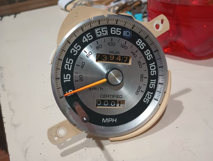

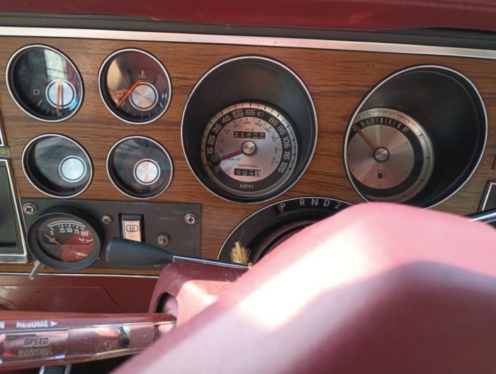

recently pulled the 125mph speedo from my parts car. would love to put this in my Civ gran fury. just some things i'd like to know. are 125mph speedometer cables easy to come by? i think RockAuto had em? are they compatible with cruise control? i don't really care if my cruise control gets cut off, i never use it. can i take the speedometer face plate off and stick it to my 85mph cluster. my 125 cluster is quite rusty and dirty plus I'd like to keep my same mileage. i tried pulling the needle off but it seems its not budging. any tips and tricks about this would be helpful- Thanks.

for now my dash just don't look right with the 85 Speedo

You’d have to pull the odometer and roll by hand. You can find videos on how to do it. I don’t know about just switching face plates.
Civilian speedometer cable worked fine when I put in my 125mph speedometer, I didn’t have an issue with it reading correctly until I swapped my rear end and put 3.21 gears into the car. Now I need to change the speedo gear in the trans to get it to read correctly. It’s about 10-15mph over the the actual speed at the moment.

The speedometer doesn't need any extra work. The cable and gear are the same. You can't just swap the faces the rest of the speedometer that makes the needle move is different.

100% just plugged in the entire 125mph speedo and fuel gauge assembly into my stock civilian dash and it worked and functioned perfectly.

trying to roll back the miles now and these numbers don't wanna budge. the gap isn't too big. my car is at 71k and this one reads 73k. i guess i can wait to put it in and swap it then. i gotta stick something in the cable slot and Ferris Bueller it?
Gotta open up the back and pull it. Has a gear lock to keep it from rolling back. That’s why I used the civilian speedo for a test dummy

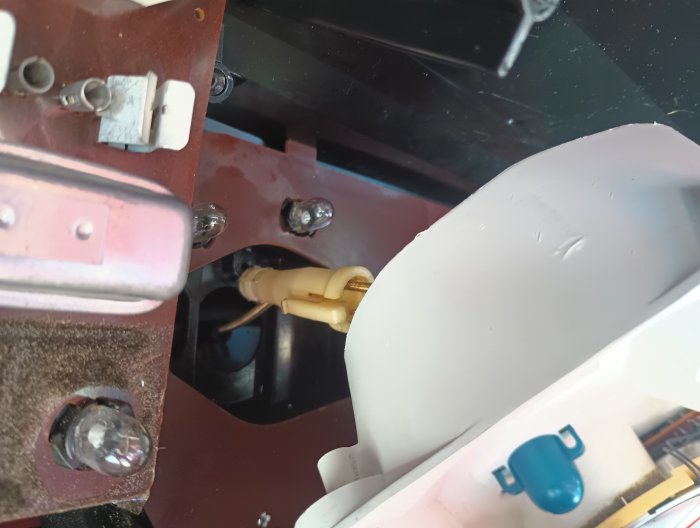

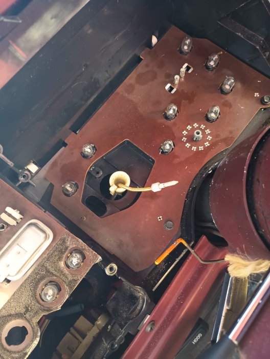

i put it in the car, holy crap was it a pain in the ass to plug back in. pull out that cable a bit? it gets kinked when trying to push it back in, hardly any hand space. when all was said and done it works, but it makes a clicking noise and between 5-25 mph it kinda just bounces up and down. i bet this means the cable isn't all the way in but no i'm not gonna take this dash apart again until i get really annoyed. above 25 it works fine

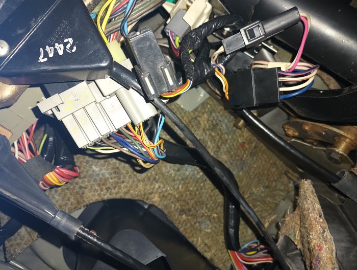

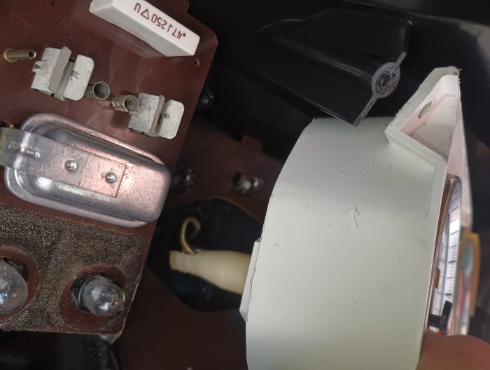

so... in my quest to simply swap out one gauge it would seem i ruined the entire cluster. A+ mechanic here boys. so at first when i put the 125 speedo in it would make a rattling noise and only work above 35mph. so today i went out to attempt to fix it. it seems the speedo cable is pulled out kinda far. i tried tucking it back in but she isn't budging. i put everything back together and now. both my speedo and gas gauge no longer work at all. the lights still work but no speedo, go gas gauge. i checked if the cluster is plugged in. definitely is. also checked the fuse box. everything is good. i got no idea. only thing i can guess is somehow the speedometer cable broke or fell out behind the dash but she looked plugged in. there was one connector under the dash idk what it goes to hanging out. i guess this fiasco tells me i may be the worst mechanic in the Baltimore Metro area. any help would be greatly appreciated.

Whoa, did the cable end pulled/break out of the clip? That’s a bummer man.

seems like it did when i pulled the gauge cluster out. was kinda stuck. think maybe it got pulled out of the transmission on the other end? think is it worked (though poorly) when i initially put the speedo back in so idk whats up now and why both it and the gas gauge are dead. i guess i ought to just have a shop look at
UPDATE: so i snapped the speedo cable when pulling on the cluster. was kinda hard to get my hand behind it to pull the tab off as it'd been on there for over 30 years. stupid mistake and that'll run me 150 bucks for repair. at least i'll have her back this weekend
