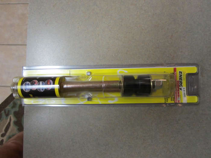

My ES end link kit showed up today. I opted black. The bushing is backordered till the 21st. It's a one inch bushing in black. 9.8149G is the part number for this end link kit.

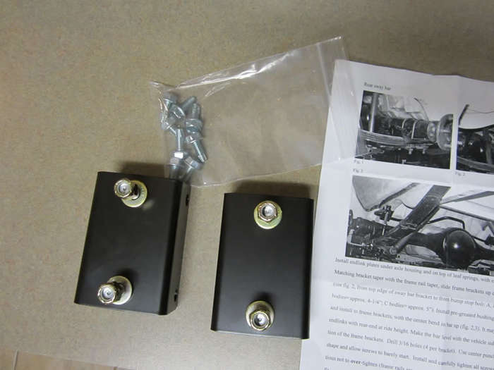

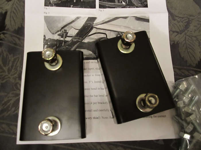

Finally got the brackets from Firm Feel just took pics and did not get to slide them under the car yet. 75 bucks to the door was fine by me.
