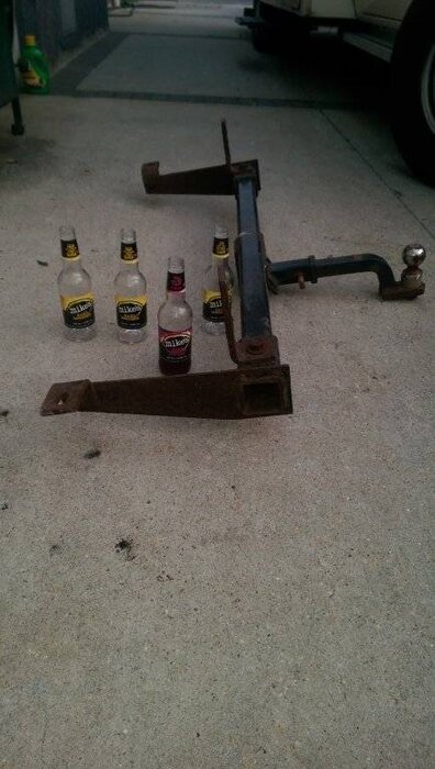

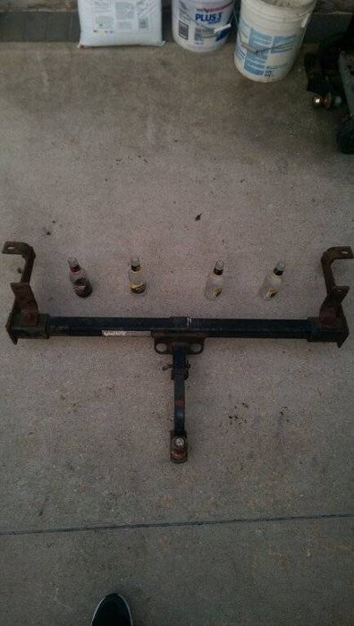

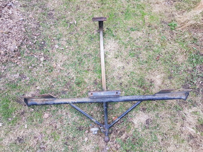

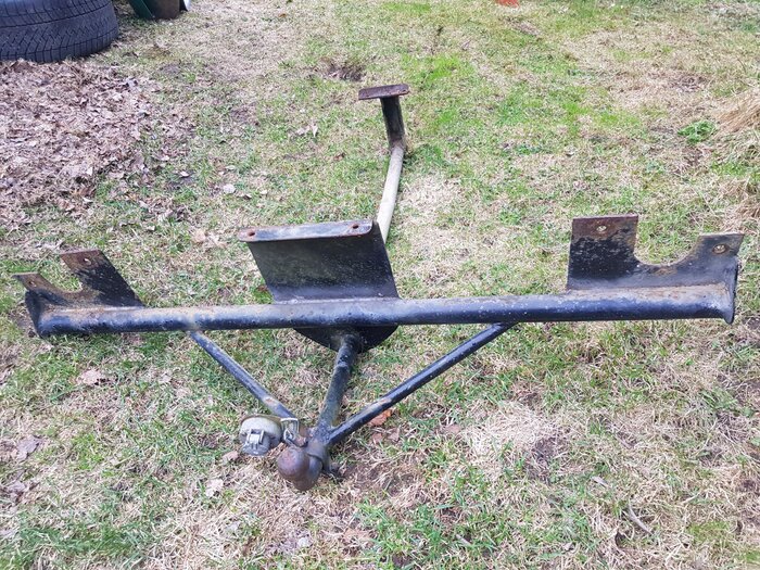

Here is the one I removed from my Aspen. Not the best pictures, but it will give you an idea where the mounting points was located.
Two bumper bolts on each side, two bolts through the trunk floor at the back and two bolts through the trunk floor in front of the fuel tank.

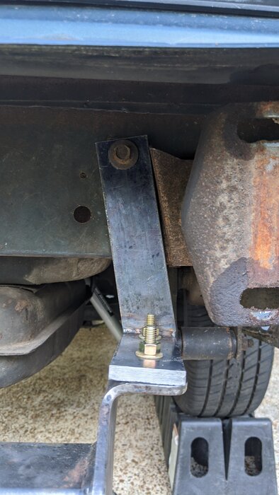

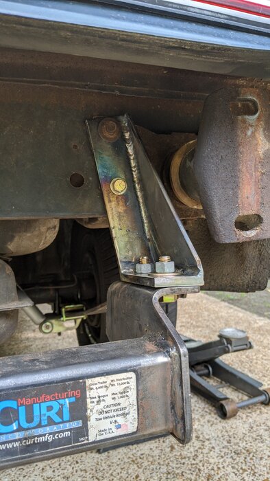

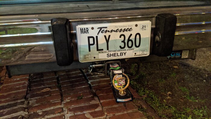

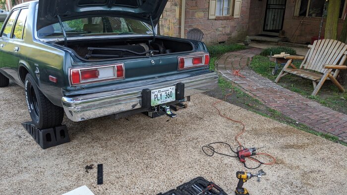

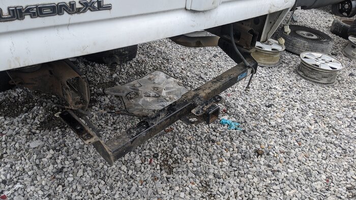

I'm working on one right now, seems like they're all similar ideas. I used a hitch I pulled off a Yukon at the junkyard, made brackets to adapt it to the bumper mounts. Tomorrow I'm adding bracing toward the front of the car, either the trunk pan or frame rails. Still going to be light duty only, but hopefully I'll be solid for whatever I throw at it.

Looks really good, but what's the thing with the Cadillac ornament? :D
