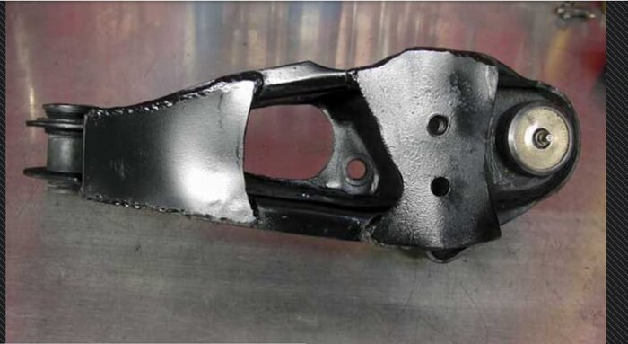

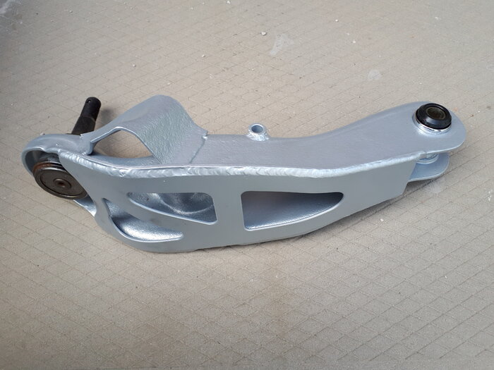

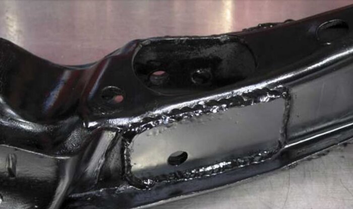

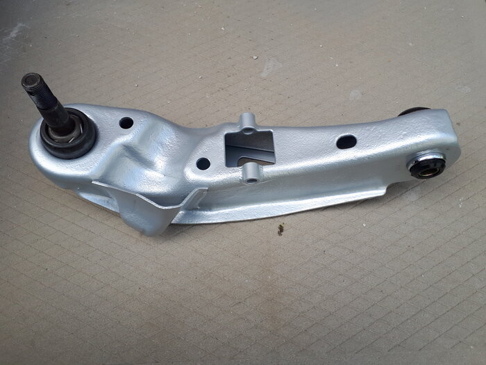

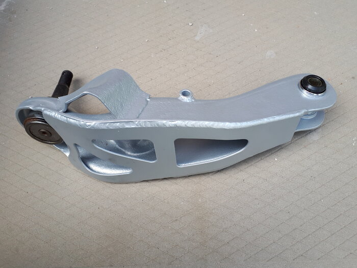

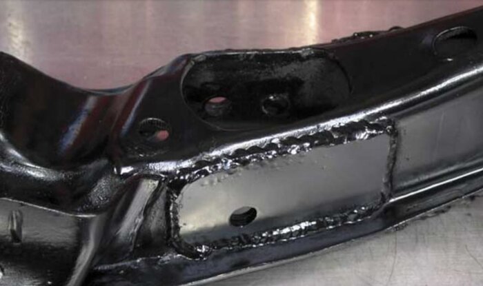

I modified my lower control arms (silver) to accept A-body shocks. You can take this further and modify them to accept early Camaro shocks. Either way you'll have a much greater selection of quality shocks.

*THAT* is the mod that was done on the Stealth Bomber that I was trying to find better pictures on.
Awesome job sir!

You are correct that different brands of shocks don't necessarily have the same length for a given application. Choose carefully. I'm using Lakewood 90/10 A-body shocks.
