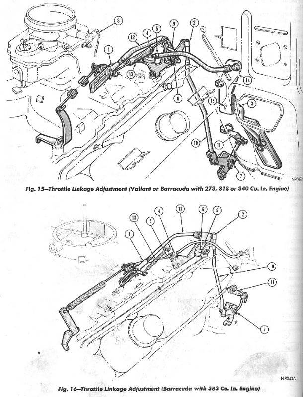

So we changed the trans and now the correct linkage has been installed. Cost me a whole ten bucks locally. I need to get it adjusted correctly any tips?
Shorty Thompson
Mar 5, 2011
858
105
Taylorville, Illinois
Just for the sake of saying it . That kickdown lever regulates the internal pressure required to shift the tranny properly . need to hook that pup up .
MiradaMegacab
1,847
753
Long Island NY
FSM- Do not drive with this trans miss-adjusted or you will be replacing it VERY soon too.
At WOT the the trans lever should be pushed all the way back. This increases line pressure. This is just a ball park estimate to start with. Use a 1/2" wrench for adjustment.

Well its in and adjusted the best I can do, I need about a half inch longer lever, I was thinking maybe all new springs as i just used what I had laying around. The pedal feels like crap from what I had before, (Jegs cable mount and return spring setup) but I noticed a big difference in the way the motor runs. Seems like it was always dragging and struggling to keep up the RPMs. Lesson learned.
Badasspen
Mar 5, 2011
98
Kent,WA
Thanks, there is still another inch of adjustment left at the trans. The book leaves out little hints like that.
