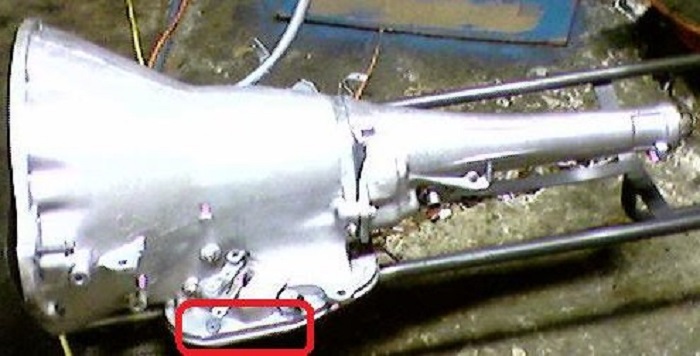

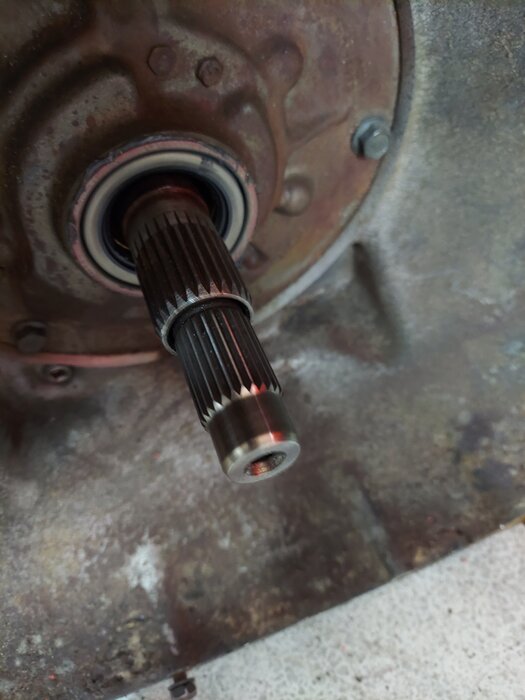

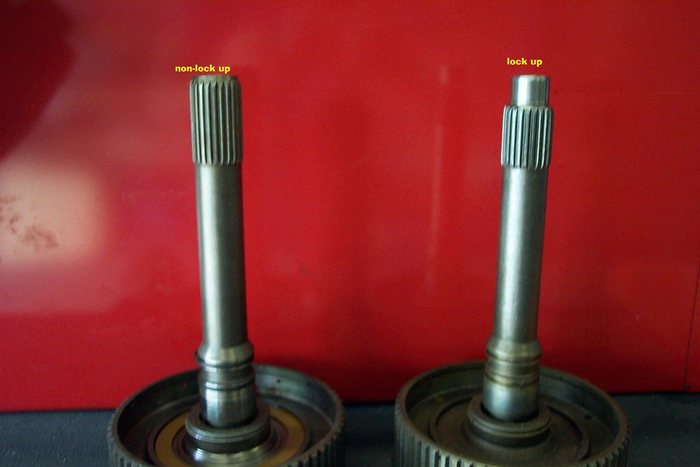

All I can tell you is it's a 904. Not sure what the numbers are. They should be stamped on the drivers side pan rail, below the shift shaft area. It'll be an 18 digit number. First 2 (letters) are plant code, then 7 digit p/n, followed by a "W" (that means nothing in the field), then the next 4 are the date code, and finally the last 4, which are the sequence code for the day. Pretty sure the 1st digits will be "PK"(?) No photo of the input shaft but, non-lock up has splines all the way to the end, lock up trans has a machined area and the splines end before the end of the shaft. On the passenger side will be the last few digits of the VIN that the trans came from on a pad cast into the case. Maybe this helps, maybe not? :oops:

Sure does. The shaft is machined at the end also. I will check for numbers when I get back out in the garage and let you know. The numbers I put on here was from the bell housing pad passenger side. Thank you

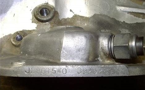

That is the last 8-digits if the VIN the transmission came out of.
The number we are looking for is here:

The spline count is (also) different on lock-up and non-lockup shafts.

So it appears you have an '88 lock up 998/999 trans, same as a 904 but with locking TC and parts related to that (input shaft, pump, valve body, etc)
