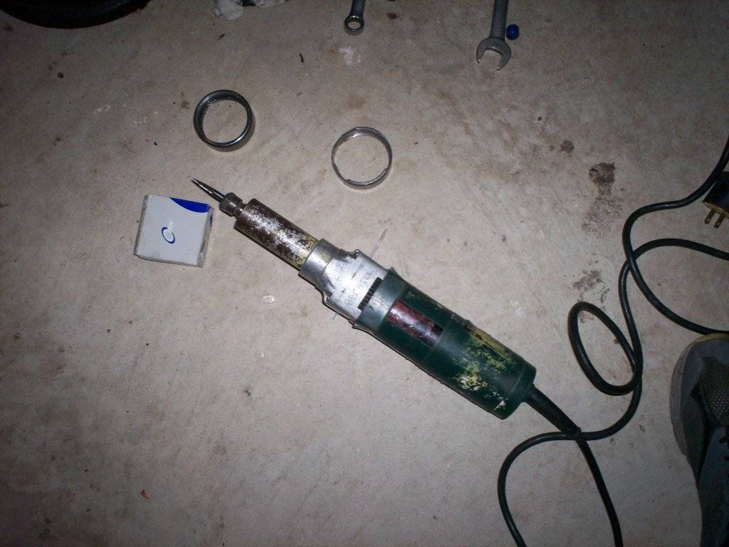

Borrowed my neighbor's Die Grinder and made the rainy day go away

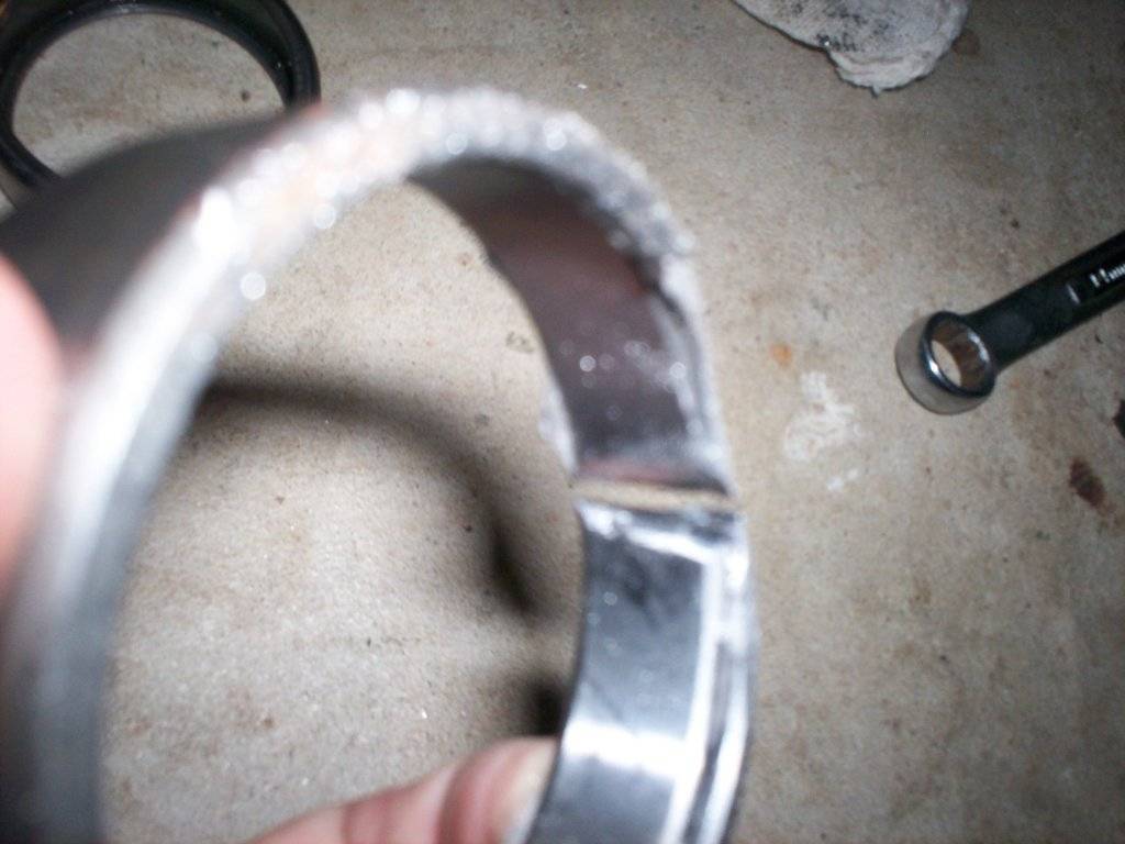

Had to split the race

Die grinder is like a much bigger dremel. 1/4" shank instead of 1/8".
With a whole lot more torque. The Die grinder will walk on you if you are not careful. I still spend 50 minutes working the die grinder with diamond bits. I still need to buy a dremel, since mine died
