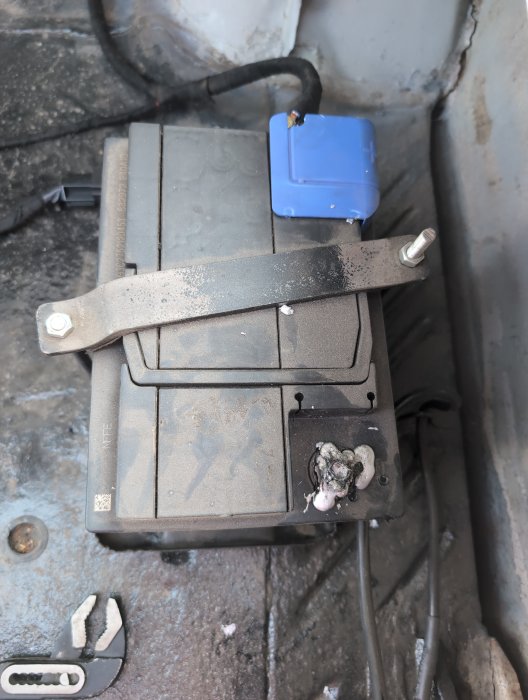

And properly tighten the screws...
Otherwise:
Happened a friend yesterday with his racer Valiant.
69-
Dec 13, 2020
512
365
Germany
The starter wire was bad and obviously connected to ground. Car ran, but at full throttle he had ignition issues and stopped it immediately, breaking the run (last run was 11.1s). We pushed it back and realized the molten pole, which itself resulted from being loose (just push on, pull off).
That was quite a lot of amps going through the high connection-resistance (being not tightened properly).
But the battery itself still showed 12.74V after the desaster. Good luck: nothing caught fire.
