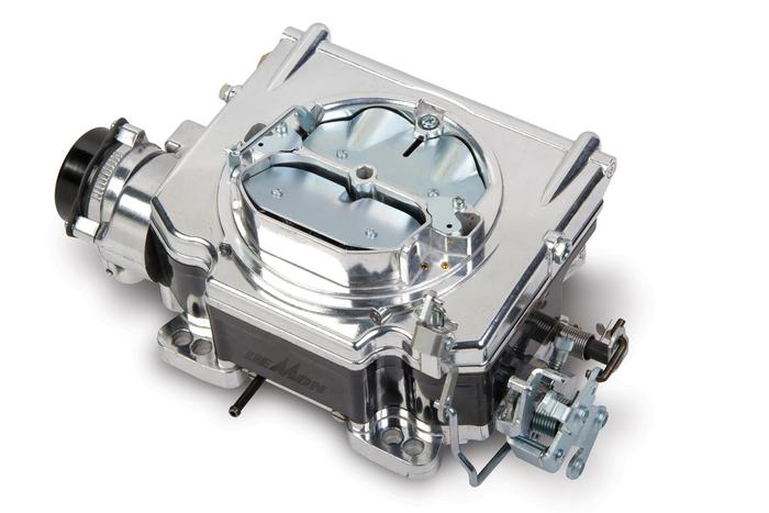

This is supposed to be the best new carb you can get for a daily driver.
Demon Carburetion Street Demon Carburetors 1901
625 is a nice good cfm for a 318. Should not bogg at all

The Street Demon carbs are spreadbores, if you look at the bottom of them, or if you take the airflow of the secondaries vs. the primaries. The secondaries are a little weird looking from the bottom, in that the one throttle plate covers both secondary barrels (ie. Goggle Valve, and that is not a misspelling). There is a version that uses a phenolic body, just like the TQ.
Also, the Demon carbs are being made by Holley.
The Street Demon carbs are the newest version of the TQ, in my mind, with some improvements to them in the form of leak prevention (there are no gaskets below fuel level), and easier adjustments for the idle speed, and secondaries.

Kkritsilas, that seems to be some pretty neat stuff on that Demon TQ. I think I will save up some coin and buy two! One for the 5th and one for my 302 ford :). I love the look.
