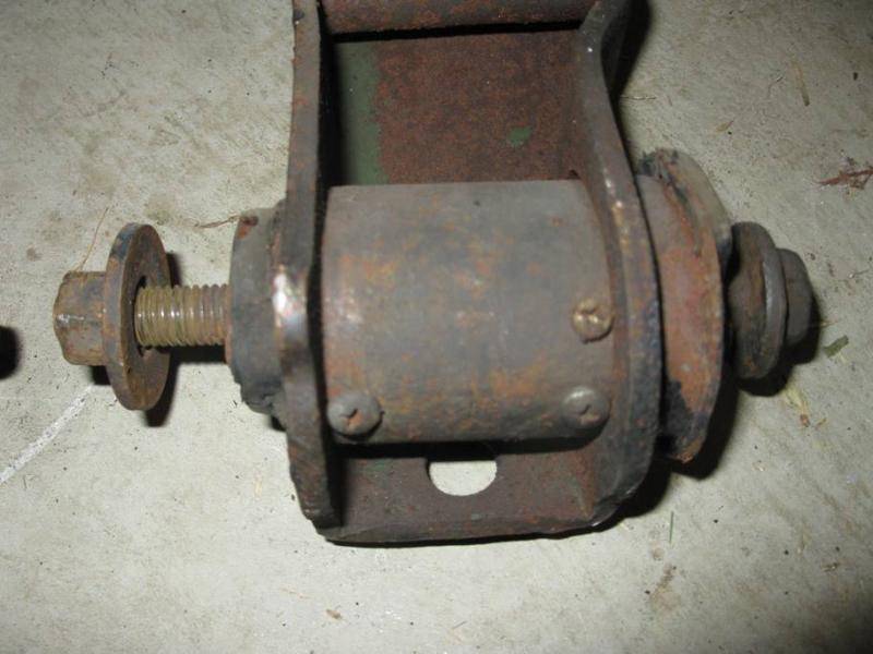

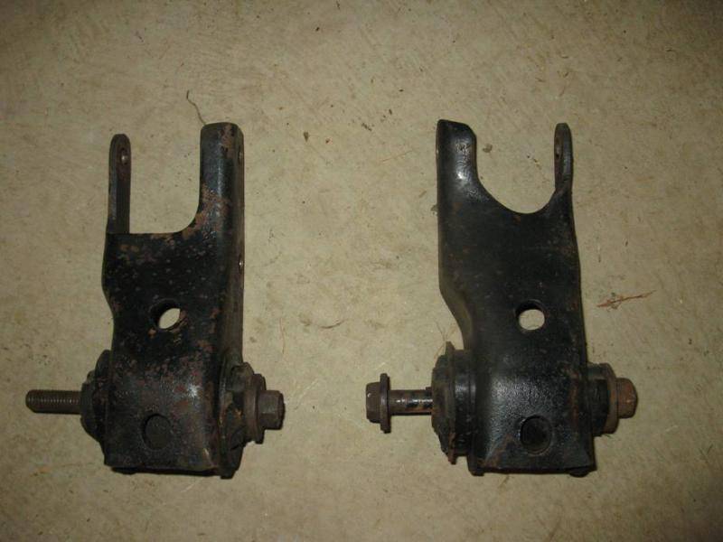

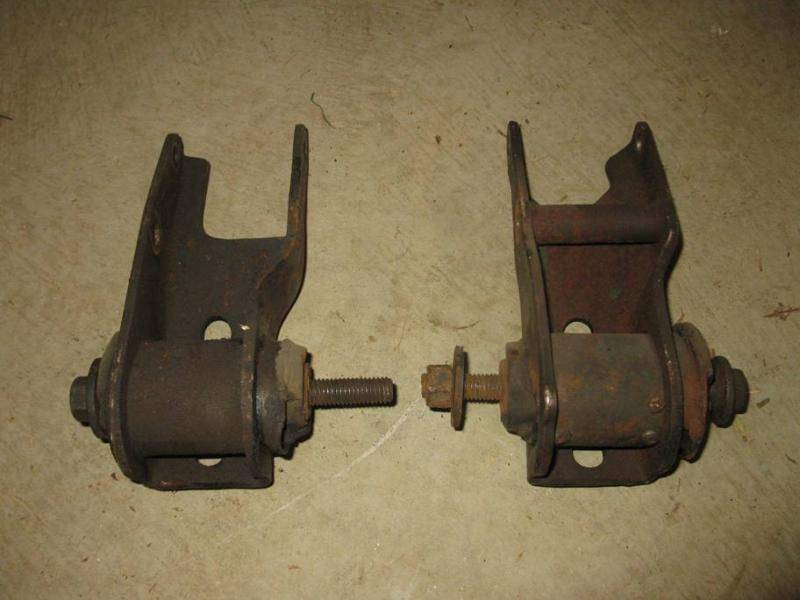

Back before Schumaker big block conversion mounts were available for the F body, I dropped a big block in for short money. I found a set of spool type mounts out of a 73 440 Fury and tried them out in my Volare big block. The passenger side mount was perfect. Block came within an eight of an inch of the blower fan but didn't touch anything. Drivers side mount was way off however. So, I unbent the tangs holding the biscuit in the mount bracket, moved it over to it's edge, drilled several holes and inserted set screws to hold it in place. Worked like a charm. I still had to grind on the K frame for oil pump clearance, but, that's the way it worked out. Broke as a joke motor mounts.
