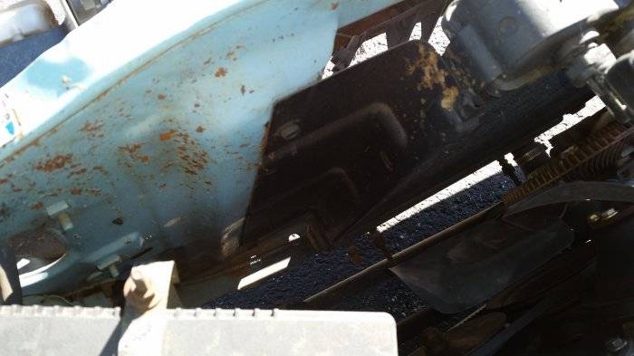

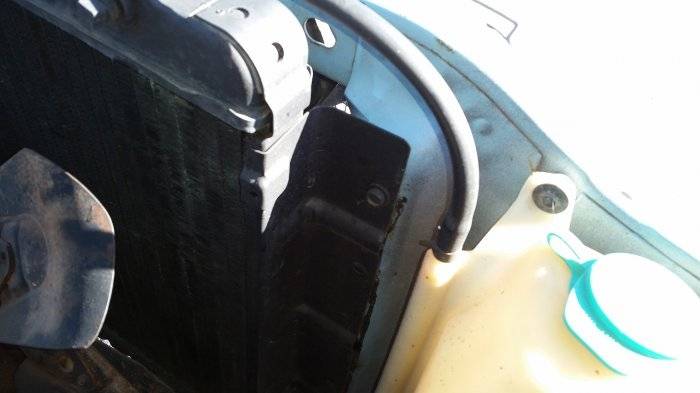

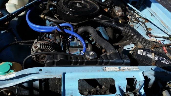

1,492
4speedJim,
Did your /6 come with A/C?
The reason I ask is most /6's and 318's without A/C came with 18” radiators, whereas most everything else (FMJ wise) comes with 26” radiators.
I’m not sure if you can bolt the wider radiator in place of the smaller one or not (without drilling holes) – but if you can, then you have the core support blocking airflow to part of the radiator (if you have the smaller core support brackets, that is), or you would need to perform some creative cutting.
My ’86 5th Ave has the bigger radiator (if you want to call it that, it is still smaller than ones used in early ‘70’s).
My ’77 station wagon has 318 without A/C – so it has the smaller radiator/smaller core support brackets on it. If I was going to install a big block into it – than that would be one more thing to fix, first.
Note: it sounds like we are both gathering parts for similar builds – so we might want to get together and compare notes.

22" radiator will bolt right in,most 318 and /6 w air had 22"

I changed the original yoke panels for the 26" ones. My car was originally a 225 without A/C and had a tiny little 18" radiator with the wide side brackets.

My ’77 wagon, 318 2-bbl without A/C, also has an 18” radiator.
The distance between bolt holes are 24”.
For a person to fit anything wider in it (26” radiator), one would have to replace the two core support uprights OR do some creative cutting to get the bigger radiator to fit, unrestricted.
I plan on putting A/C on my wagon, so I’m already planning on replacing both core support uprights (as well as a possibility of a big block w/5-speed).
