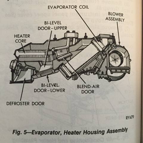

I don’t think you will save any time to remove the R/F seat.
Matter of fact, I would bet a bottle of soft drink (cold) that it would take less time to keep seat in place, than to remove seat.
Alldata labor guide shows it takes 0.9 of an hour to do (in flat rate hours - if paying a technician to do it).
Mitchell’s labor guide shows 1.3 flat rate hours to do.
My guess is it will take you about 1½ hours to do (no, I’m not betting on time it takes you).
Just think, if your car came without A/C, then it takes 2.7 hours to perform (the whole case has to come out).
