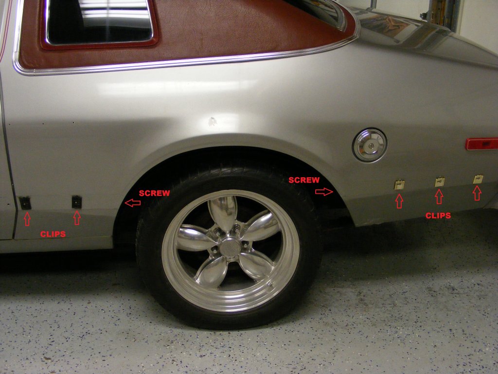

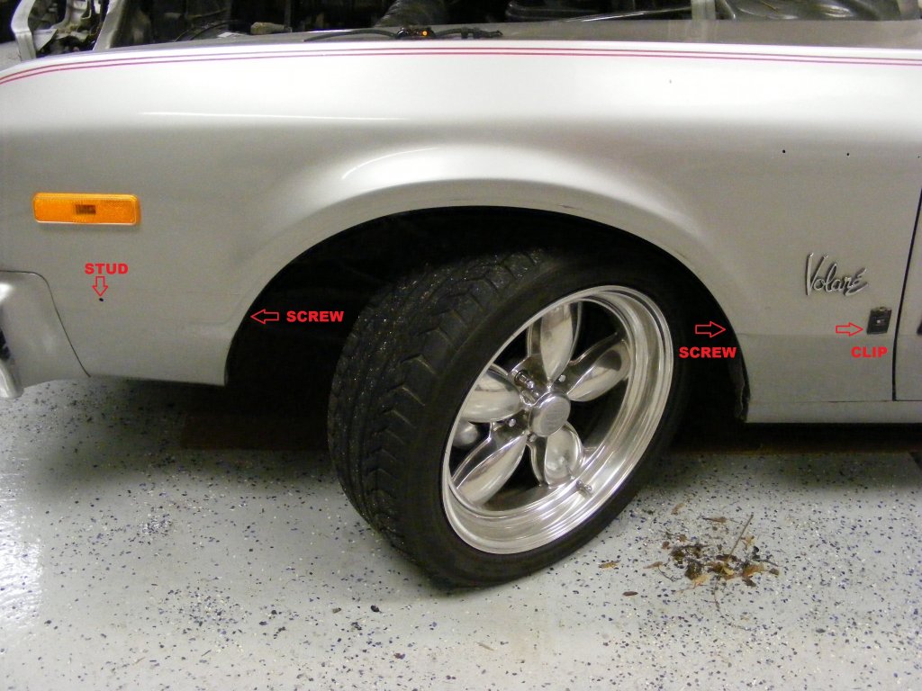

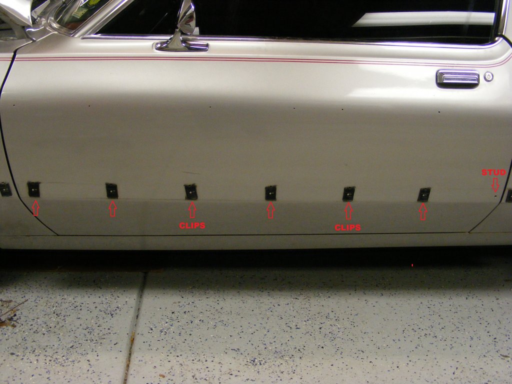

Those studs are for two missing clips (as well as for the clips you currently have). Chrysler calls them retainers.
For the missing retainers (or ones you might have broken) are:
Door:
6003332 and 6003755 (I have no idea what difference is).

Fender retainers:
6003332 and 6003581 (again, I have no idea what difference is).
