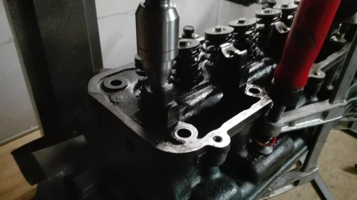

Currently I have been busy with the replacement of the valve seals in the slant.
This was easy to do with the help of a valve spring compressor and a piece of nylon wire in the cylinder.
Before I could replace the valve seals, the rocker arm assembly had to be removed.
This went fine. However, I noticed already that the last and longest mounting bolt of this assembly took some iron jacks during disassembly.
Unfortunately, when the rockers were assembled, the damage had already been done. The screw thread was already damaged in the cylinder head.

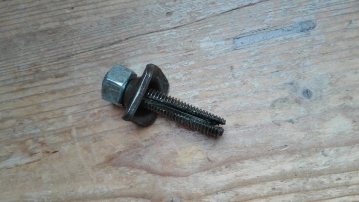

I saw that this bolt did not look original. Apparently, a replacement bolt has been fabricated and assembled. This bolt is an M10x1.5. I also see that a slot has been made with a grinding tool. Bolt shown in first picture.

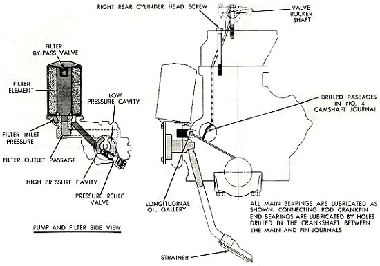

My question, is this done as an oil passage for the supply to the rockers and push rods? I have been able to find an image on the internet about how the lubrication runs in the block.

You are correct about where the oil supply to the rocker shaft comes from. My guess is the slot was cut into the bolt to attempt to make it into a self-tapping bolt to ram a metric bolt into an SAE thread. You can put a Heli-Coil in the hole. The threads of the hole are below the oil passage so just be sure the Heli-Coil is the same way.
On second thought, that bolt looks kind of short. Did they thread the upper part of the bolt hole for this bolt? If so, the groove could be for oil. Normally, the oil goes past the bolt in the larger bore above the threads. I really hope I'm remembering this all correctly, it's still early..............:confused:

The bolt is made according to me from a threaded rod. Where a nut is fixed. In view of this, the thread would run longer.
Yesterday I could not see very well in the twilight if the top bore was much bigger than the screw thread.
But as you indicate, it seems likely to me that they have made a self-tapping bolt.
I intend to make a fitting M10 bolt of a round bar RVS. But then I do not have to drill a hole to pass oil.

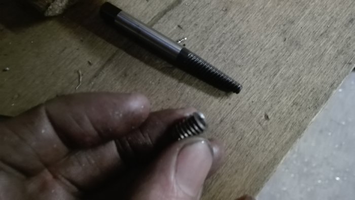

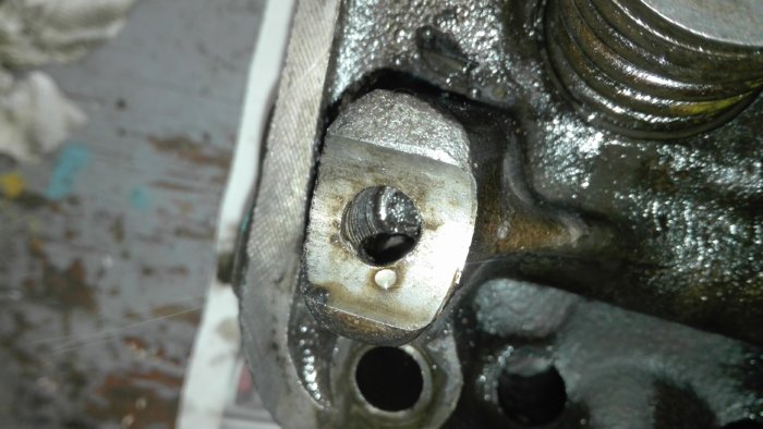

I have removed the cylinder head of the engine.
As in the first photo can be seen, the original bolt was broken. This at the level of the oil supply channel.

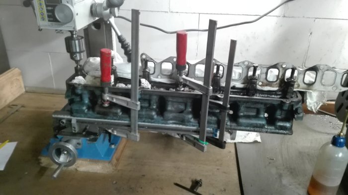

So I have mounted the head on a milling machine. Centered on the corresponding threaded hole.
The broken bolt came out of the thread-hole quite easily. This with the help of drilling a hole and using a left tap.
The length of the broken piece of wire is around 12 mm. This seems to me sufficient to mount the original bolt (8.5 turns).
I have now ordered a UNC 5/16 x 2.1 / 4 bolt.
Because of this I do not need to tap a metric thread or apply Heli-Coil.
So it would be assembled on the engine soon.
