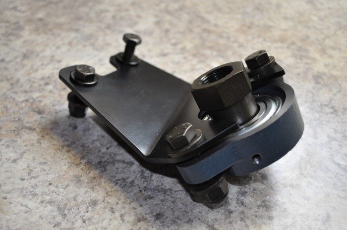

    As far as Duke5A video goes, FFI has a fix for that: http://www.firmfeel.com/a_body_mopar_sector_support_kit.html - but not one that directly fits FMJ K-frames.

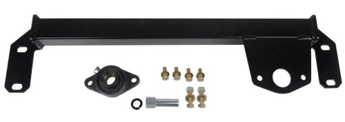

    I have a similar system on my Dodge pickup that looks like this:
    On the full-size pickups, the lower gear bushing wears out causing a fluid leak – but more importantly, the loose bushing/shaft causes a “death wobble” at highway speeds, which is quite scary . . . correction, extremely scary.
    After installing the above setup on my pickup (and a replacement gear) – all problems went away and it feels so much better taking tight turns now. The large bracket (pickup) is HUGE and must weigh 25-30 pounds.
    The bearing and gear adaptor/nut is the same one they are using on the FFI kit.
    I want to get the FFI sector shaft stabilizer kit (part number SSK) and make it fit on my two vehicles – as well as weld up/reinforce the crap out of my K-frames, when I get to that point.
